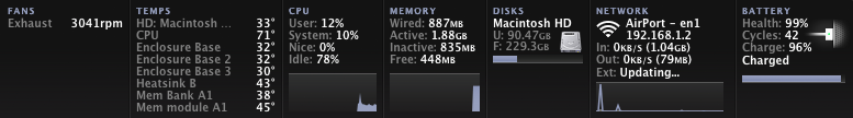

    Here are my specs for iStats. My MBP was making a small crackling noise and then it went back to the grinding noise. Temps in Celsius
    [​IMG]
