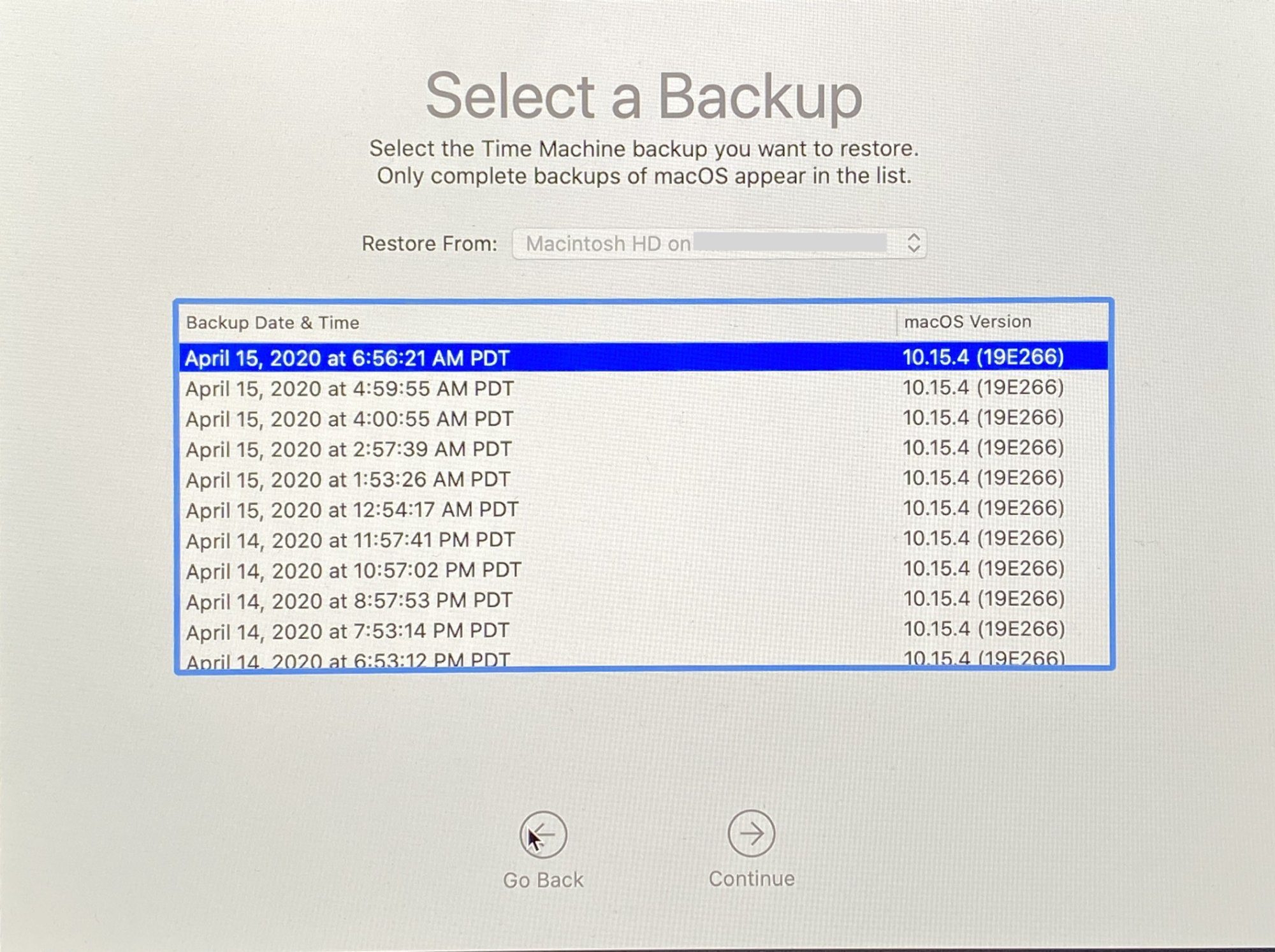

Okay, so I was able to boot up holding Cmd+R to bring me into Repair Mode. From here I am able to see a list of my recent Time Machine Backups:
Then it asks where I'd like to restore the backup to:
So should I choose to restore it to Macintosh HD, or to Data?

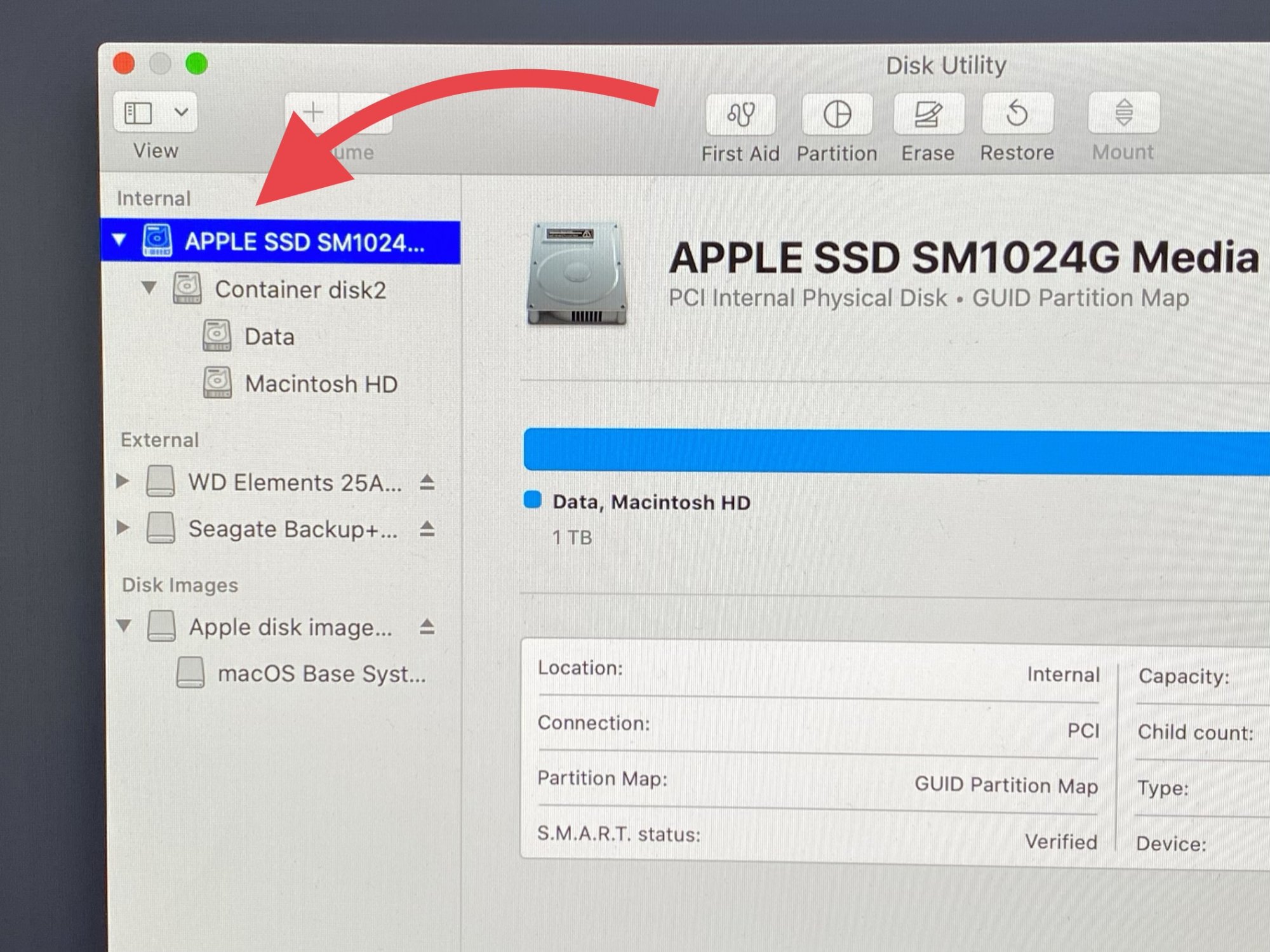

So the in the screenshot below below, you're suggesting I erase the volume named "APPLE SSD SM1024"?

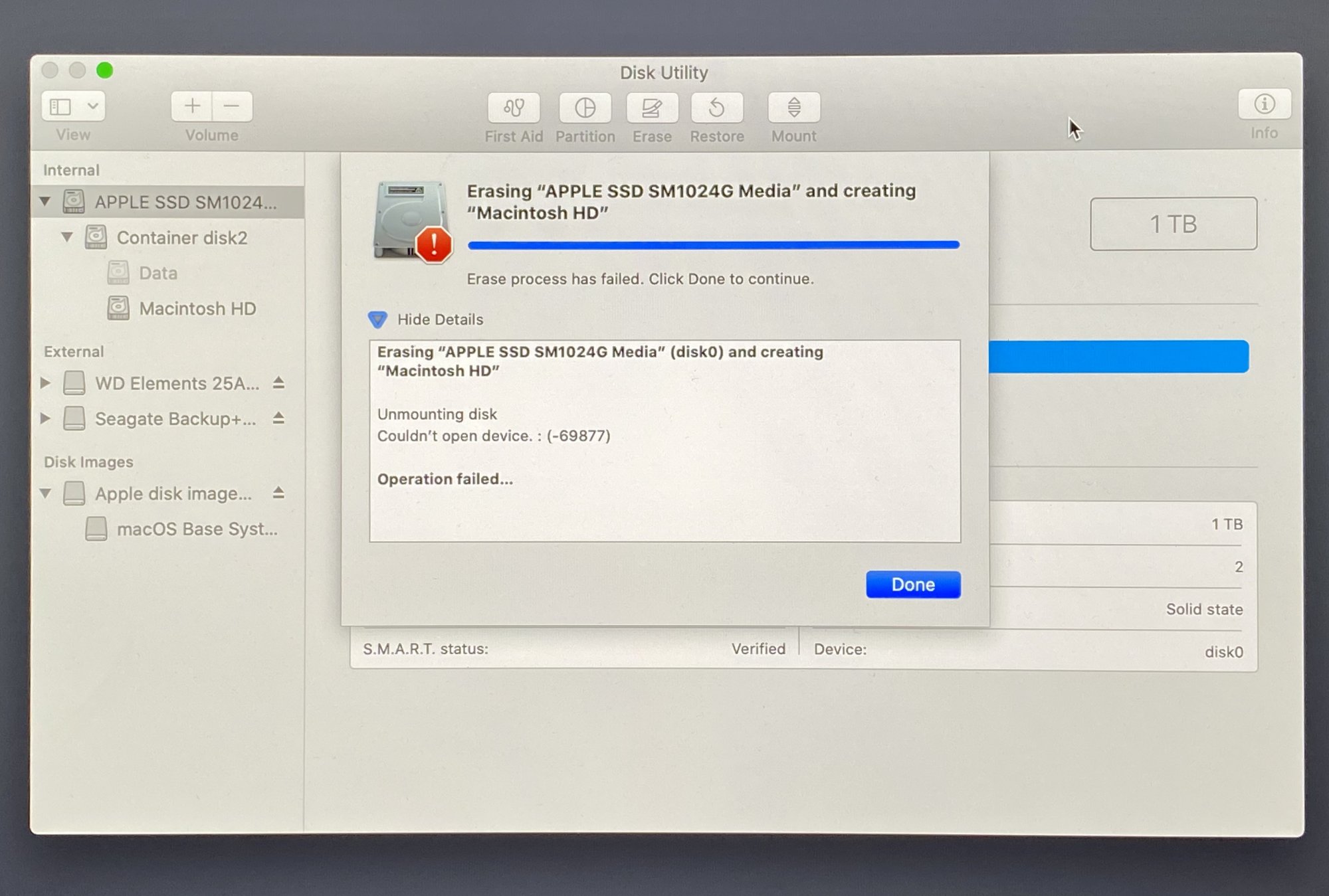

Dang!!! I thought it would work this time around. Instead, when I followed everyone's instructions above and hit 'Erase' on the "APPLE SSD SM1024" volume, this is what I got:
Thoughts?

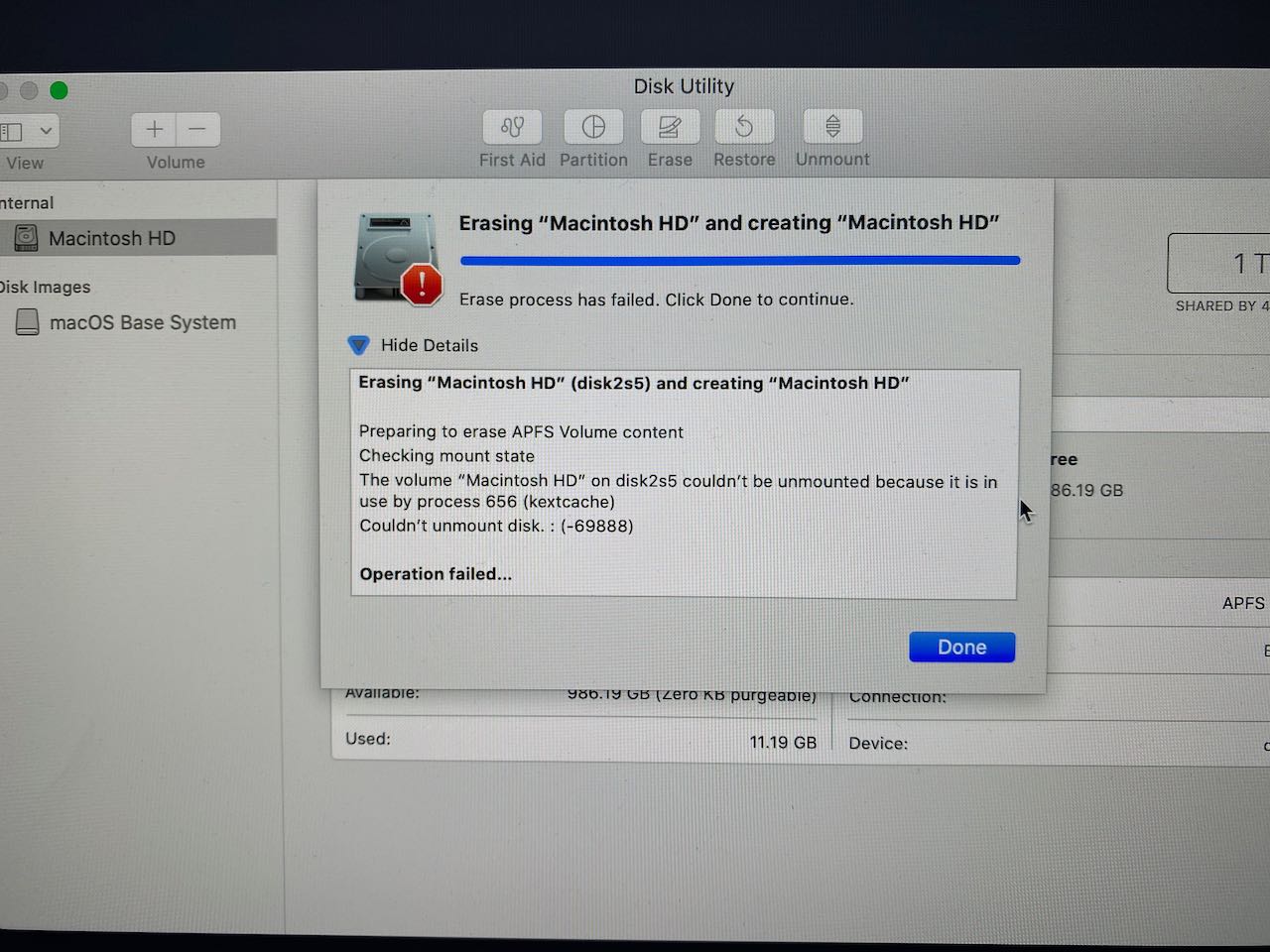

Once I hit the 'Done' button and returned to the main Disk Utility window I noticed that the partition 'Data' had been unmounted, but that the 'Macintosh HD' partition wasn't. I tried manually unmounting it and it gave me the following message:
Not sure if this is relevant whatsoever, but it would seem that it can't erase the partition because disk utility is possibly being run from it. Could be wrong about this though. I figured it was worth sharing just in case.
Let me know what you guys think I should try next. Thanks!!!

OK, well, I simply ran first aid on the Macintosh HD partition and then tried again and it worked this time around!
I don’t expect to have any issues moving forward with the MacOS reinstallation, so it looks like I’m out of the woods. I’ll let you guys know if there are any more hiccups along the way.

I actually never knew about Command-Option-R for internet restore. Great tip! Thanks for that!
Don’t know if it’s too late, but yes, erase at the top level “Apple SSD” and then reinstall from there. Good luck!
