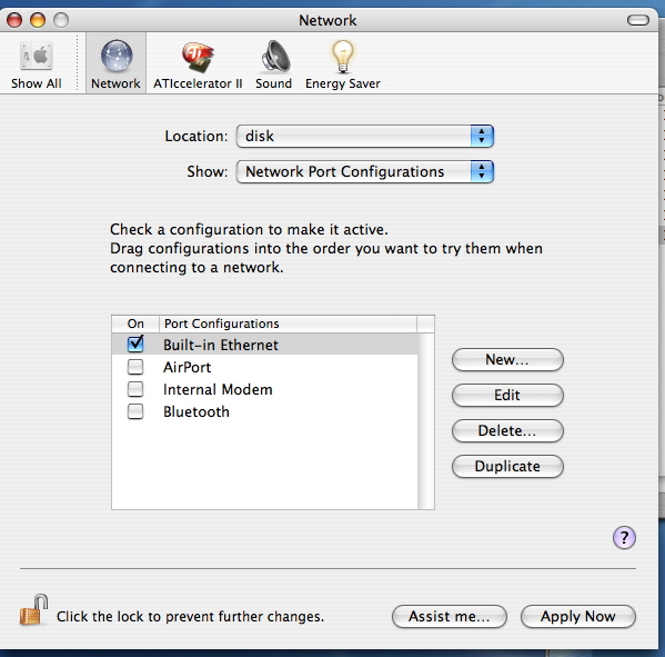

    Settings and Clues: I have it connected directly out of the drive's ethernet port and into my Mac's ethernet port using the ethernet cable the drive came with.
    In my network system pref I have only the ethernet port enabled, TCP/IP using DHCP, and everything else unchecked. When I switch from my airport network settings over to that (attempted) disk network setting, the drive's ethernet status light blinks for about 30 seconds, then goes solid, as the manual seems to say it should do.

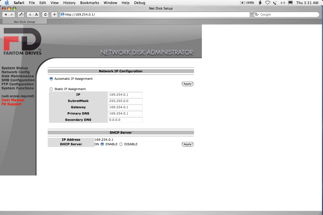

    Is your Mac using a 169.254.0.* address too? If not it won't work. Try creating a new network location and setting a static IP in this range. If that works then you will need to find out how to reconfigure the drive to be in the same range as the rest of your network...

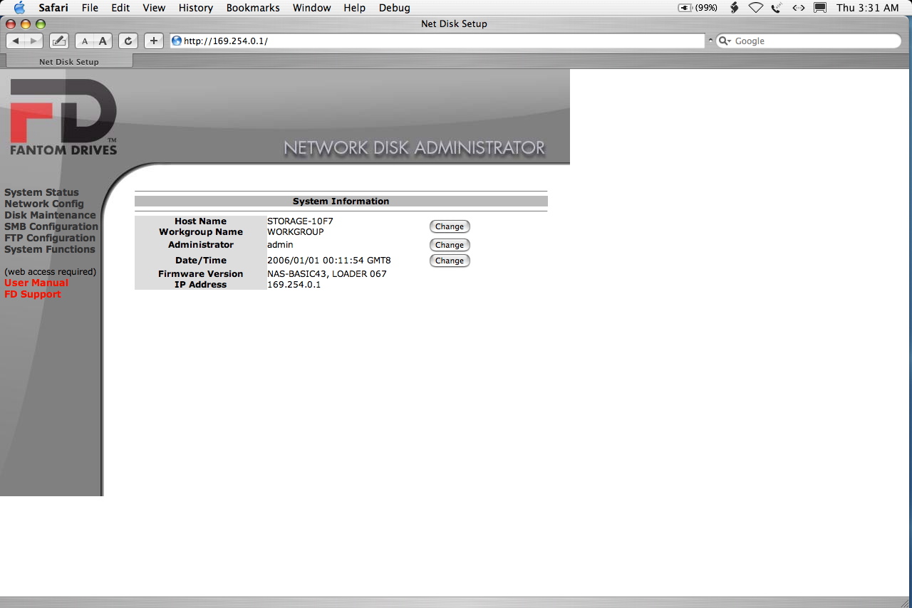

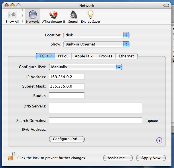

    I set my Mac to Configure IP Manually, set IP = 169.254.0.2, and tried the router = 169.254.0.2 and then tried router = blank, but neither worked. Subnet =255.255.0.0 if that makes a difference.
    But this way and the old way both work in my browser to http://169.254.0.1 into the drive's interface control.

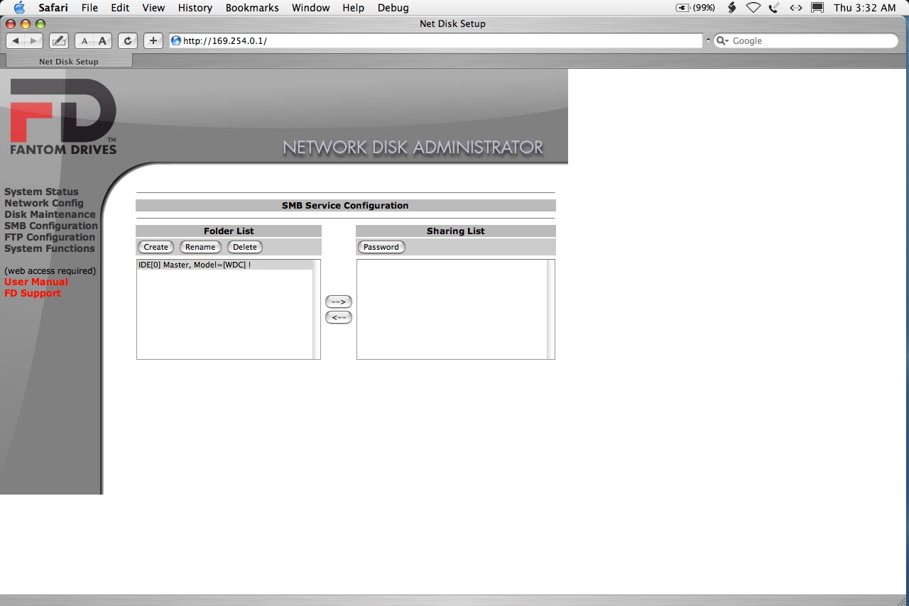

    You are trying to SMB to the whole device. Have you created a shared SMB folder (see 3.4 in the manual) and connecting to that. If you created a folder called "test" then the address would be:
    smb://169.254.0.1/test

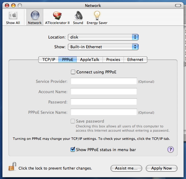

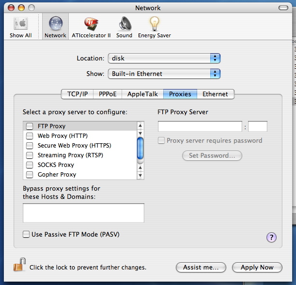

    Haha, no, I'm not sure at all. The manual is terrible, I put a link to the manual in my original post. If you can make heads or tails of it then you're the man.

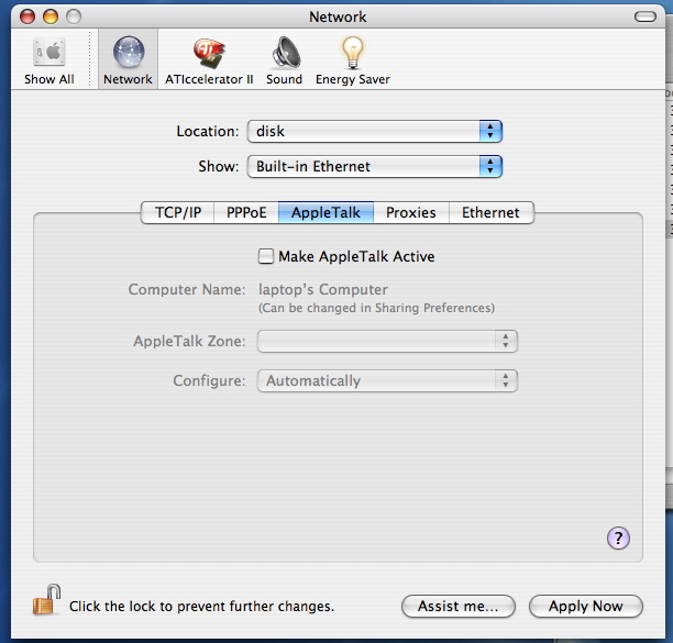

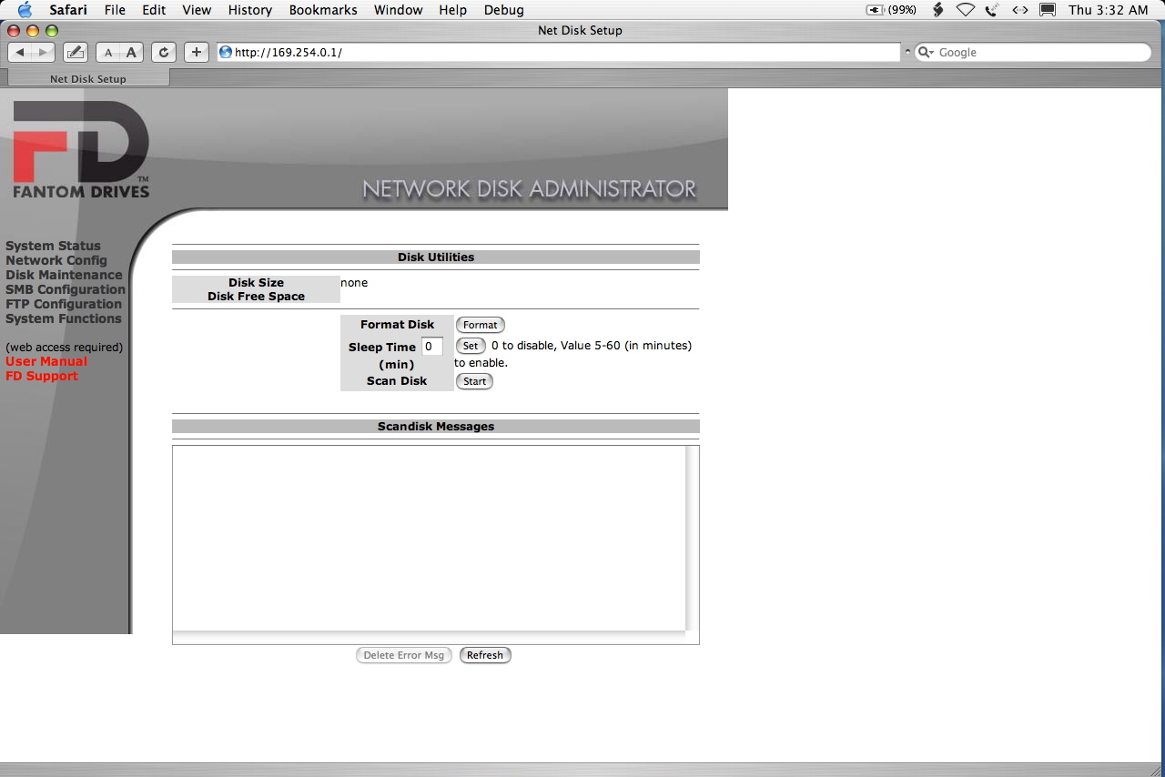

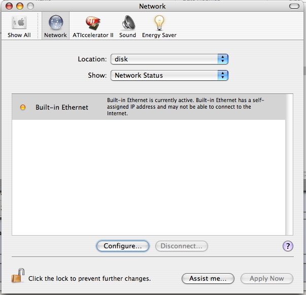

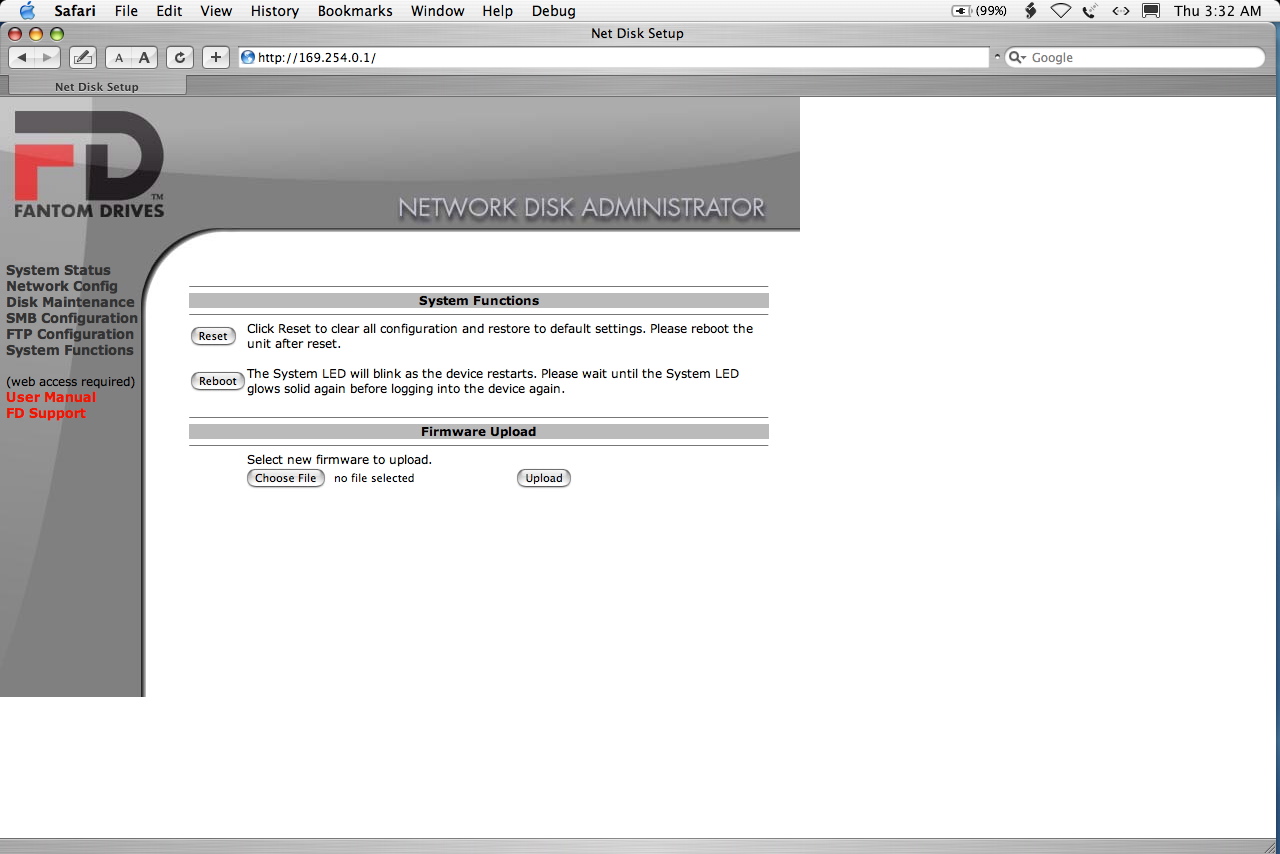

    Here are all the relevant screenshots I could think of.

    Good find. That will certainly be an issue. Also on one of the screenshots above it clearly shows that you have not defined any shares...

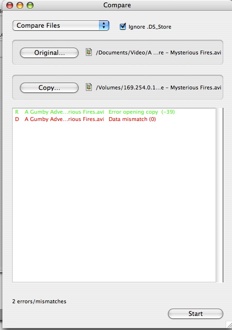

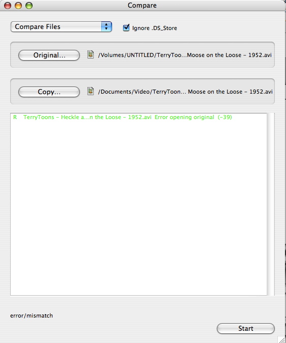

    Holy crap! That solved the 1st problem, but I still have the major original problem. I reformatted via the web interface (and it also recreated the public folder) and now the drive shows up when I connect to server and manually type in the smb address. But now it's back to the corrupt file copy problem that made me try reformatting it in the first place. Using the finder I drag and drop a 50 Mb movie file, the copy completes, but the file is messed up and when I do a compare with toast it says this:

    Does the corruption happen when copying through both USB as well as the network?
    Do you have access to another computer to test a copy from?

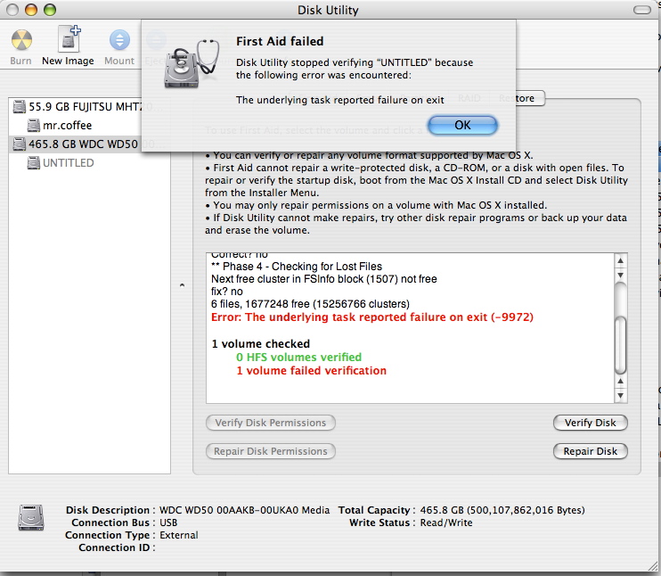

    After the transfer of the file, disk utility returns the following error:
    Verifying volume “UNTITLED”
    ** /dev/disk2s1
    ** Phase 1 - Read FAT
    ** Phase 2 - Check Cluster Chains
    ** Phase 3 - Checking Directories
    `..' entry in /PUBLIC has non-zero start cluster
    Correct? no
    ** Phase 4 - Checking for Lost Files
    Next free cluster in FSInfo block (1507) not free
    fix? no
    6 files, 1677248 free (15256766 clusters)
    Error: The underlying task reported failure on exit (-9972)
    1 volume checked
    0 HFS volumes verified
    1 volume failed verification
