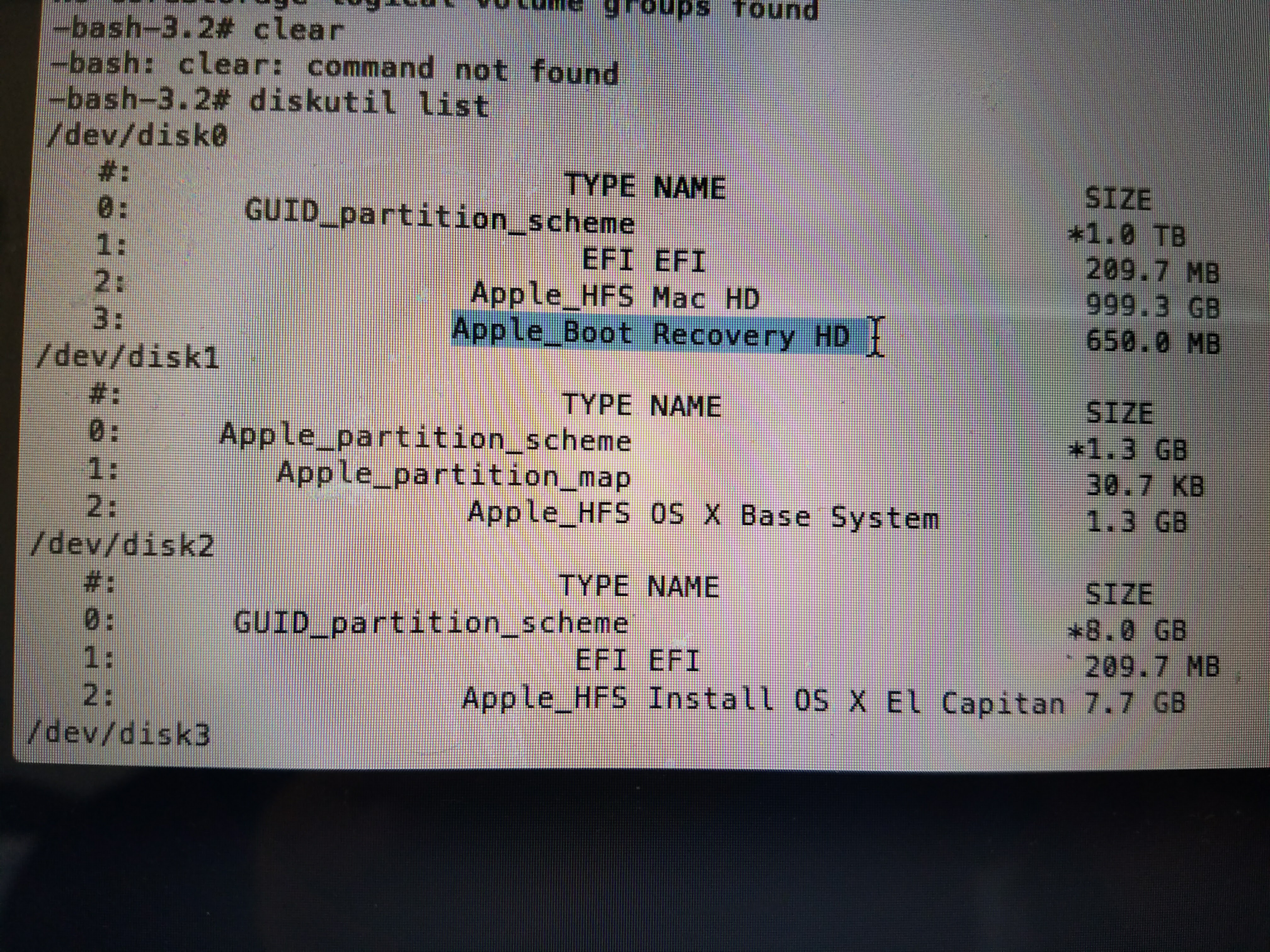

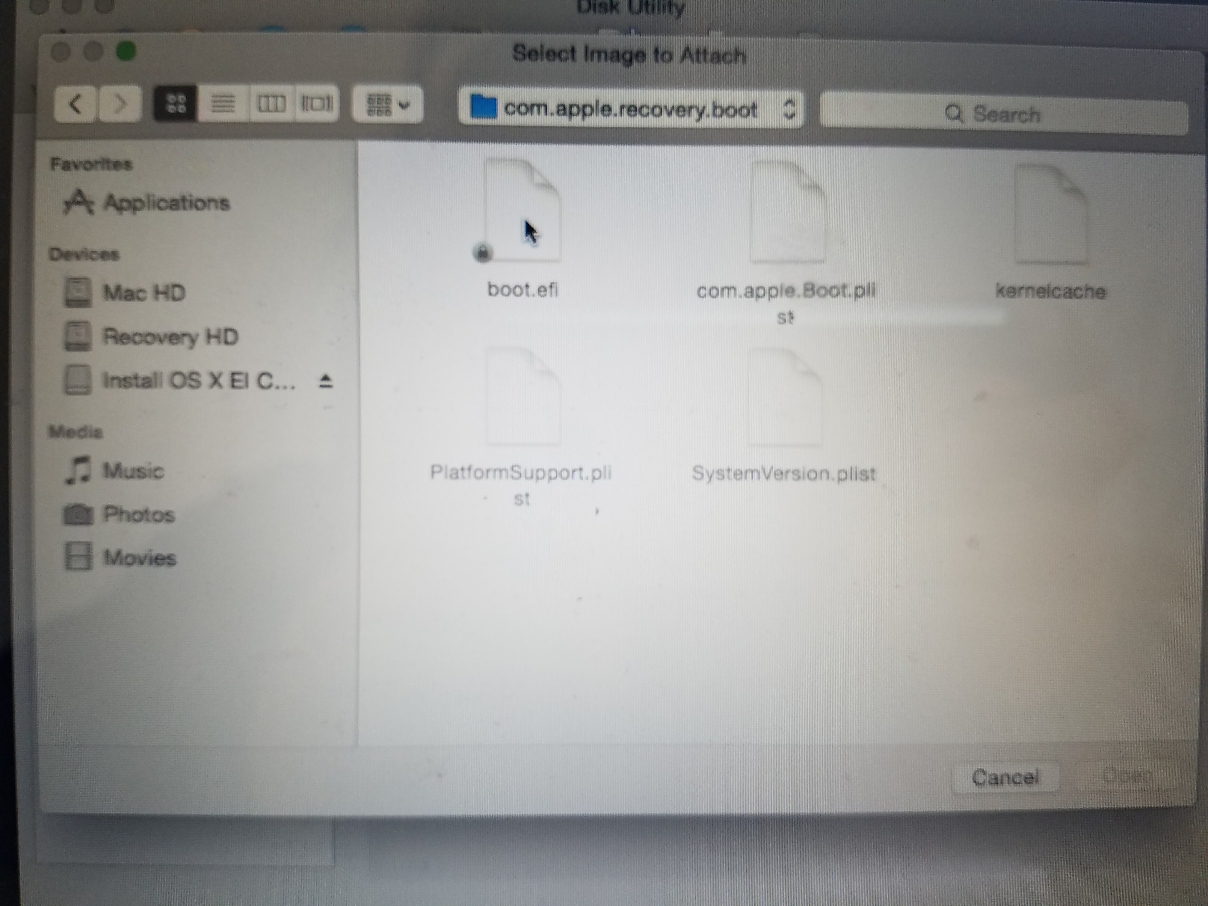

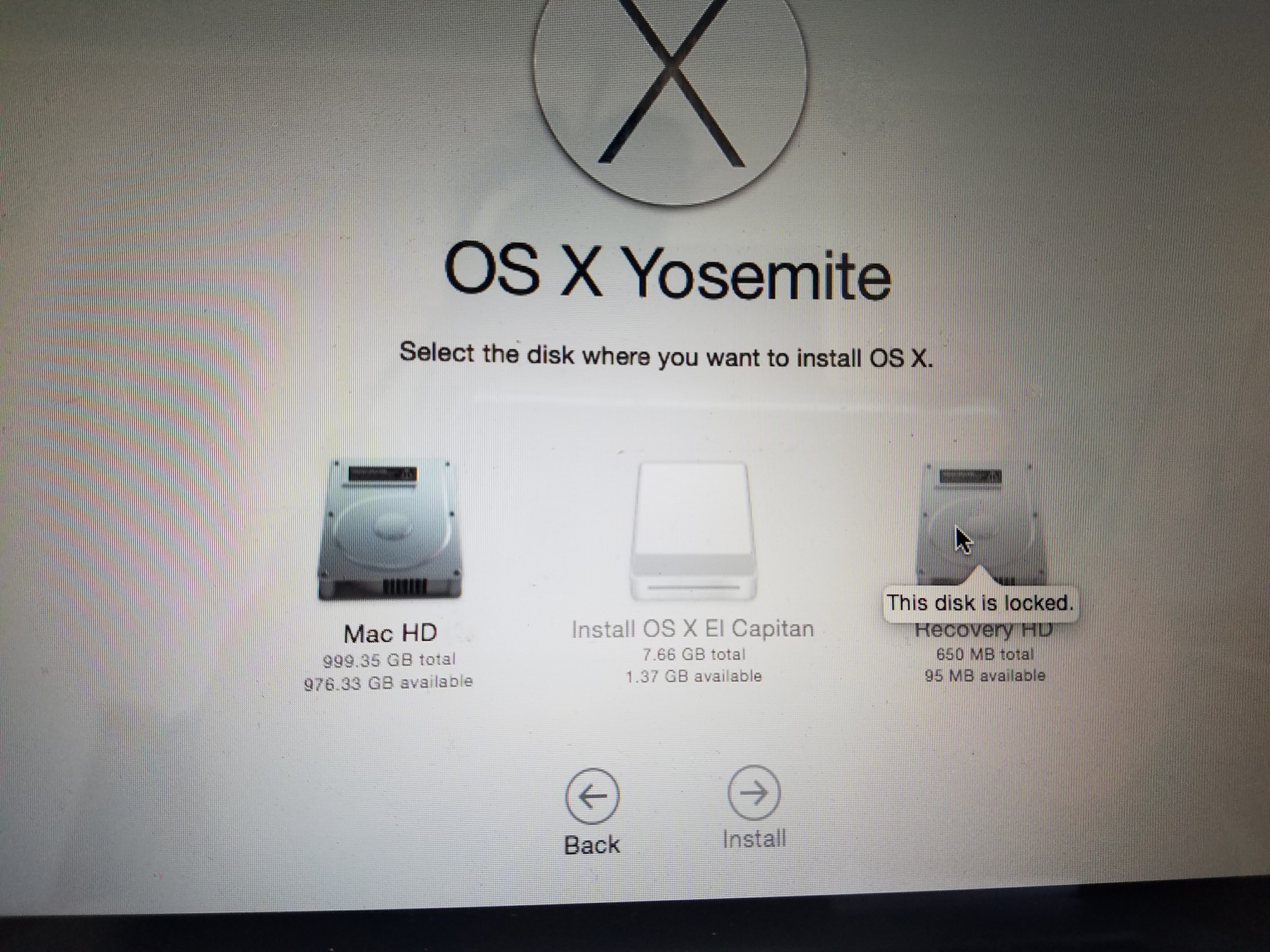

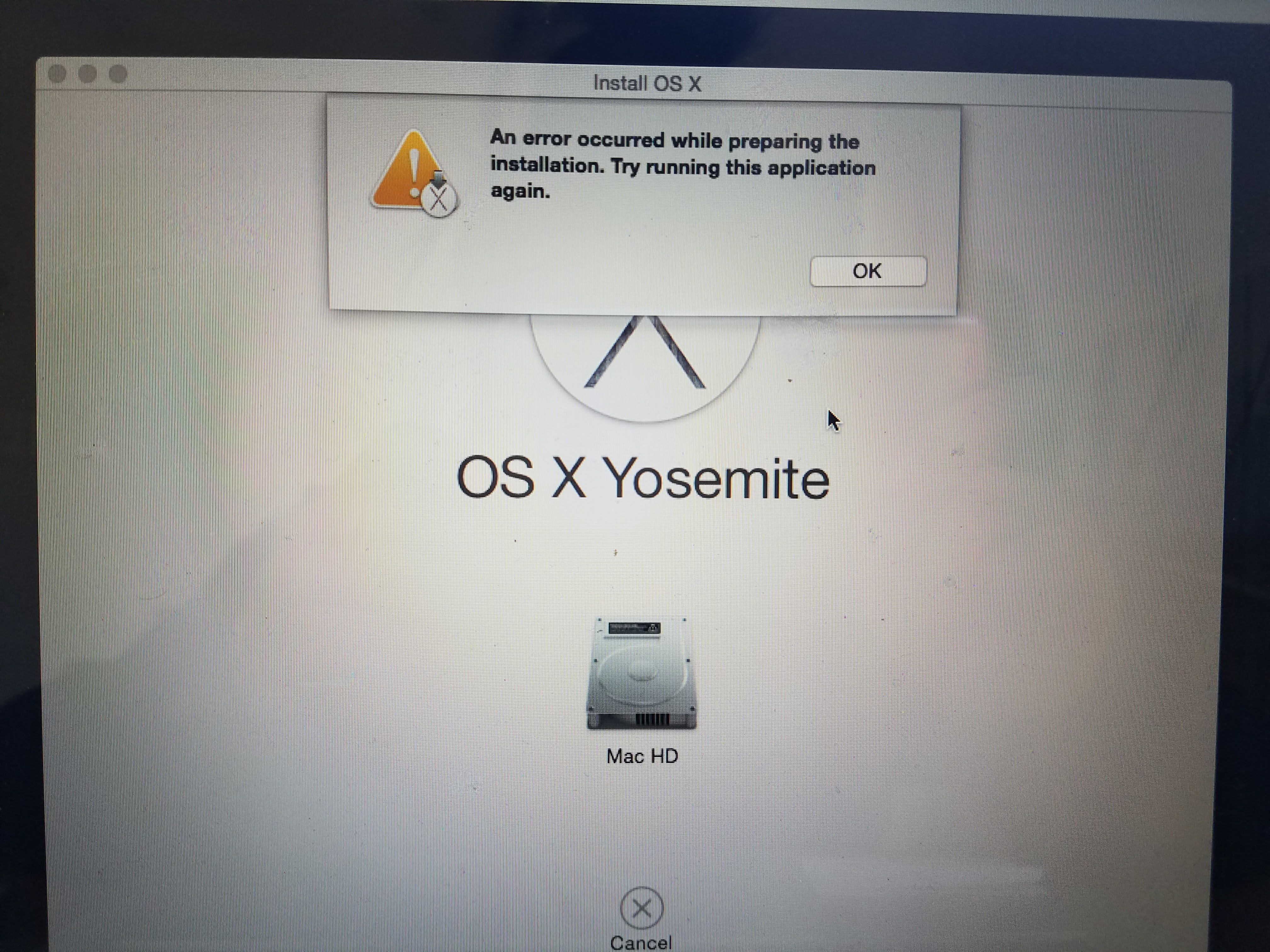

hello! please anyone can help me. I have the same problem! recovery HD its locked and I can't reinstall os. I try all the commands that you guys give. nothing work please help!!

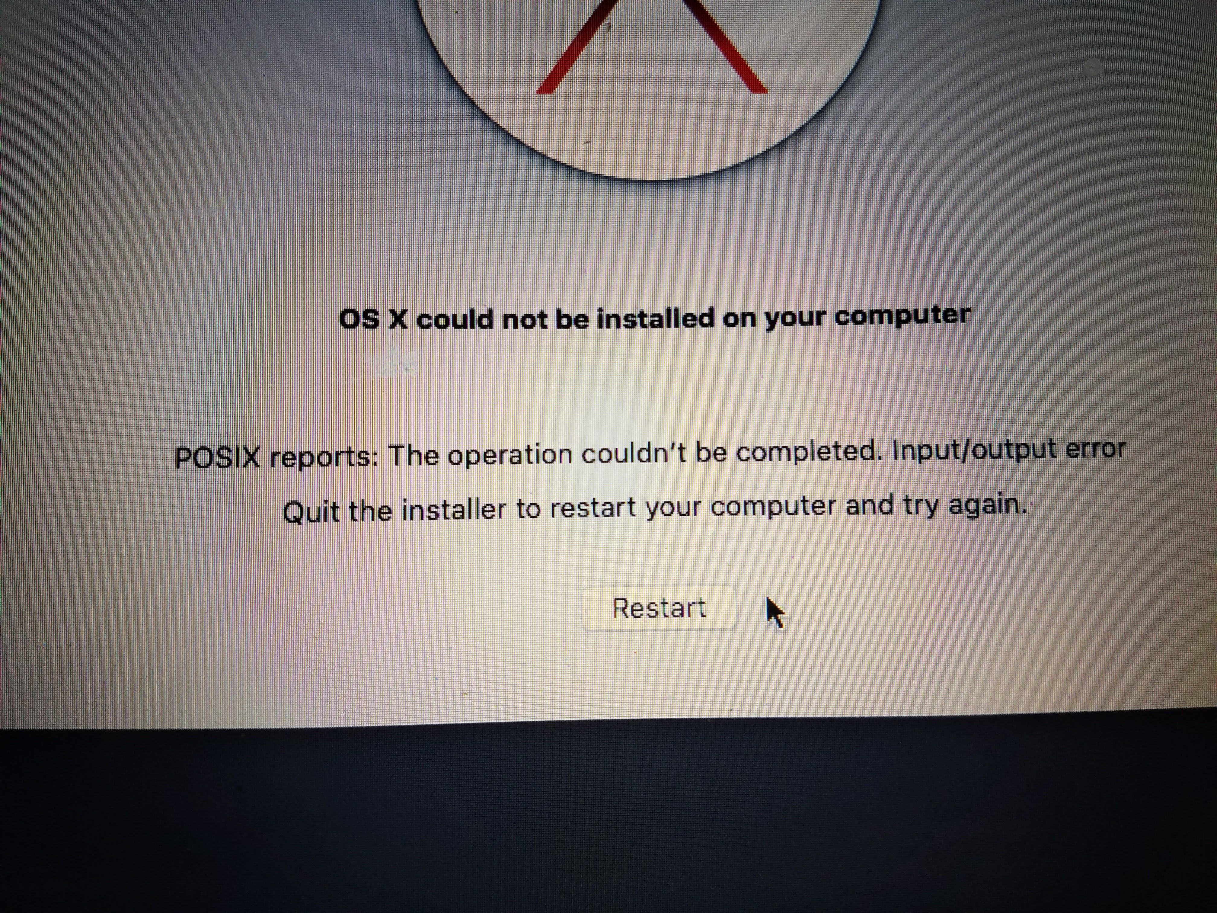

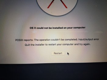

Thank you Gokhan, so i mount it and install it in my other mac and it works, I was able to install OS and used. I think something its wrong with my other computer. so after I installed the OS in my other computer I mount it to my holder computer but it just got stack in the booting logo. Before i did all this i did open firmware and it was unlocked. there is a drive " recovery HD" that its locked and it doesn't let me install OS" I tried from the internet and from a bootable USB. and it give me an error.

That error looks like it could be the actual HD itself or worse a hardware issue on the actual computer
Try booting from another HD on that machine if it works then my bet is , that it's the disk if not then something is up with that machine , run apple hardware test to see if that picks up anything
