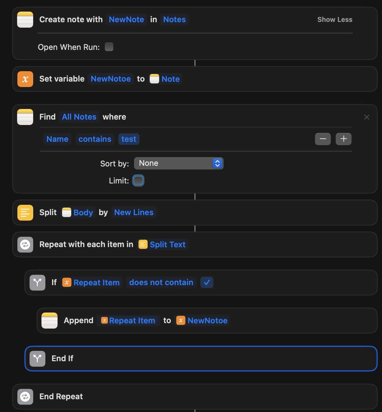

If looking to create a new checklist, not really, from what I can tell. Can get close and would require some manual effort.
Basic outline attached.

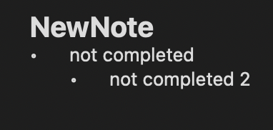

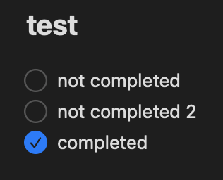

If start with this:
Will wind up with something like this:
Would need to do some text replacements to handle the leading tabs that cause the indentations. And then would need to pull-up the Note in Notes and select all and tap on the checklist icon to make each line a checklist item.
If start with this:
Would need to do some text replacements to handle the leading tabs that cause the indentations. And then would need to pull-up the Note in Notes and select all and tap on the checklist icon.

I just wanted to ask, how do you put the checkmark in the if?
It's sort of works... it creates a long note... because I have a lot of text between the checklists in the same note. I need to get the unchecked character that work. I've tried a couple of characters with "if repeat contains "but the note comes out empty.
