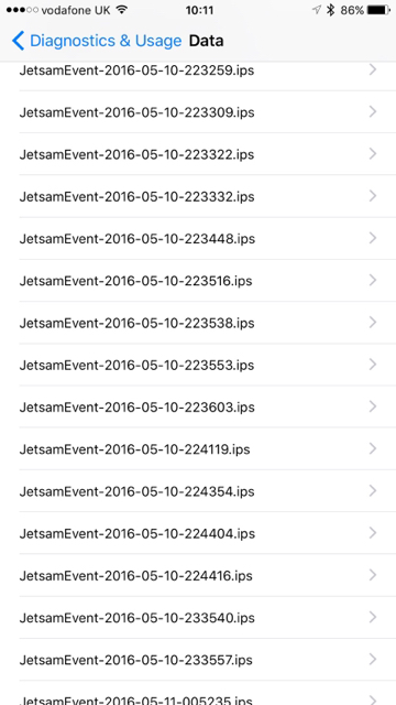

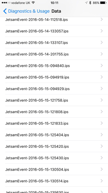

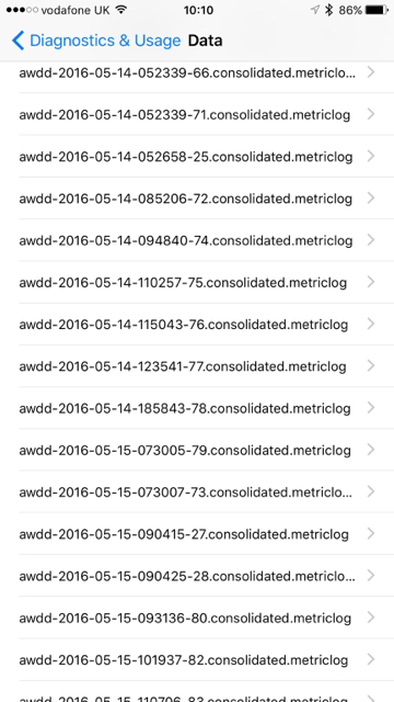

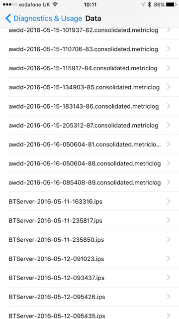

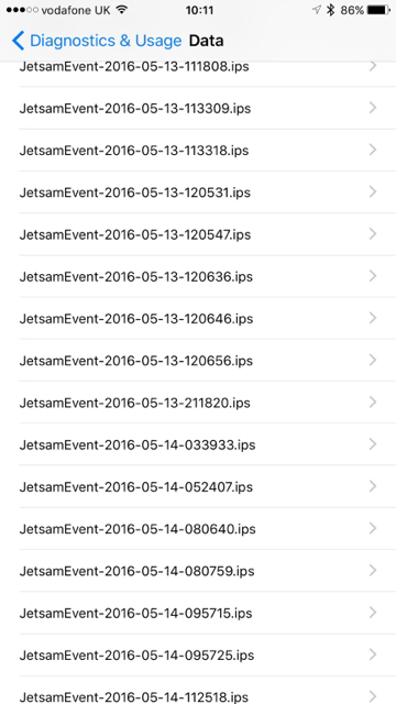

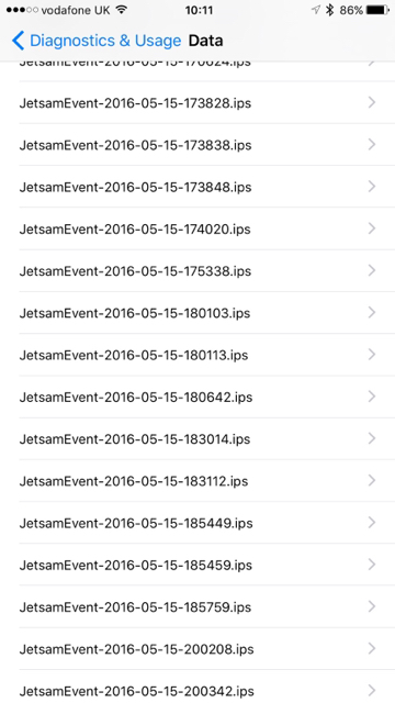

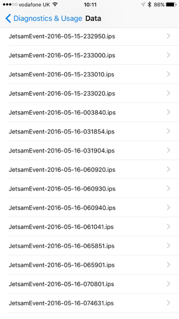

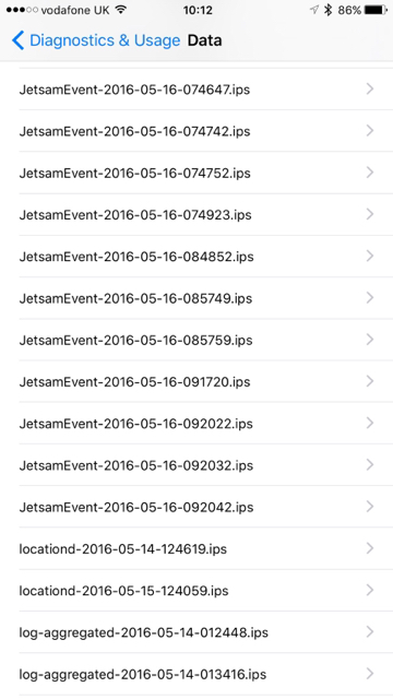

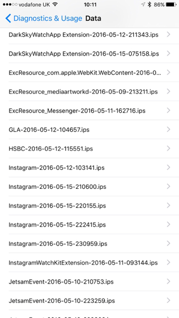

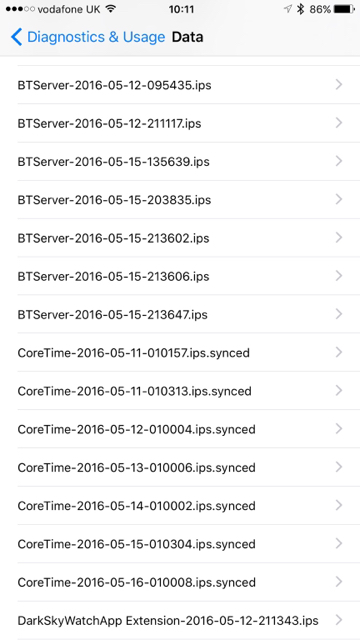

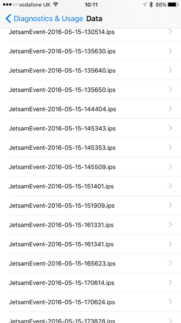

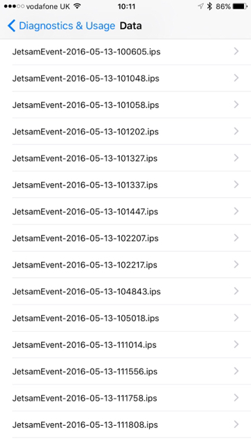

Hi Robnill!
Hey from across the Pond! Thanks for taking the time to write all of that. Really appreciate it.
So I did what you said and have turned all off and on one by one etc again. And the stuff with the keychain.
I haven't noticed a huge amount of cell usage but have noticed usage and standby time similar (though not identical).

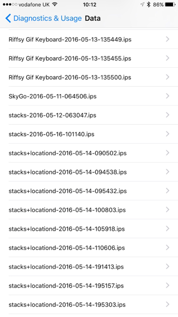

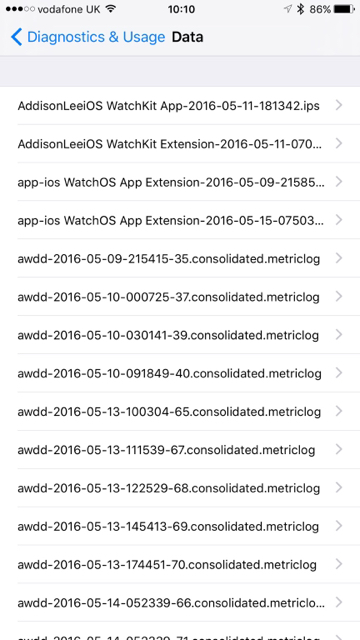

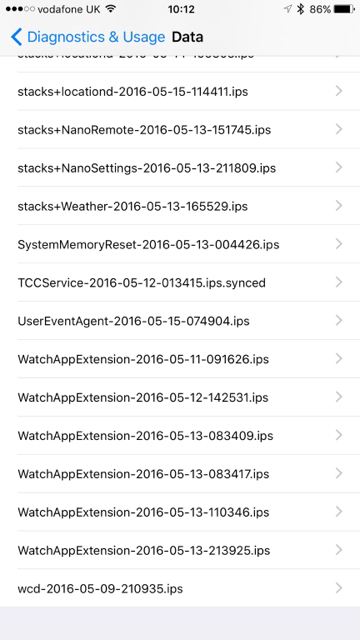

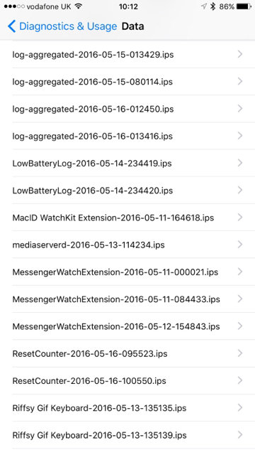

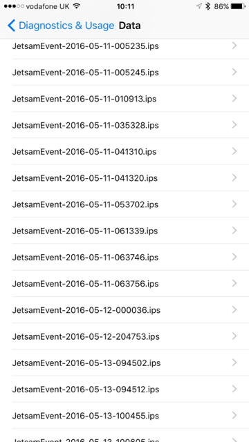

I don't have that process you mention but I do have others. Jetsam in particular. That's causing a lot of issues.
Here are some screenshots. It may as well be in Swahili for all the sense it makes to me. But does anything jump out at you here?
Thanks again!

Based on those logs I'd say your phone is quite messed up (but you already knew this). The Jetsam events are related to a lack of memory. I typically see these on jailbroken devices because some tweaks installed tend to suck up available memory or leak it (bad programming), but this is not the case. You also have a bunch of other logs regarding location daemon and a lot of other app crashes.
I'd get that phone replaced. Show the logs to a Genius at the Apple Store. 9.3+ is very stable, and you unfortunately have a lemon here.

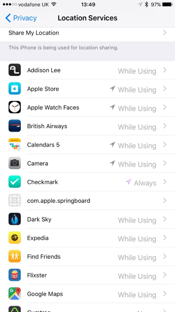

One other thing which may or may not be related.. But look what is there in my privacy settings.. It is a process rather than an app with icon. Just looks out of place. Wonder if that has anything to do with it..

Few quick questions from a luddite (forgive me!)
* If I update to 9.3.2, these logs will all disappear (aside from the screenshots), right? So I couldn't show them to a Genius
* Is 9.3.2 known to be stable? It's been a long long time since I installed a developer beta. Maybe back to iOS7's day
* Do I have to still become a developer and pay $$ to get 9.3.2 now?
1- Yes, they will. One of the goals of updating to 9.3.2 beta is to see if the same logs are generated again. If they aren't, you have your problem solved. If they do, downgrade back to 9.3.1 and it will likely occur again anyway. Then you can show those to a Genius.
2- Seeing as we're on beta 4, it's pretty much close to the final release. I'd say it's stable enough.
3- No, you simply install the beta profile and update OTA. You don't need to set up as new iPhone, but it might help. https://beta.apple.com/sp/betaprogram/guide

Hi. I don't think you have the same issue I did. The genius bar told you have apps crashing - a lot. I think the JETSAM events are low memory events - memory is being released from RAM (not your main memory but the system RAM that actually is used to run Apps) to make room for another app that needs it. Just a guess.
I'd do two things to troubleshoot - turn off background app refresh on all your apps (for now) - and perhaps turn off location services for those apps that only give you only an 'always' choice - I feel more comfortable with those apps - that give you the choice of 'while using.' See if you can make an educated guess as to which of those apps may be causing an issue. I have read some people have run into issues with Mail app connections to a MS exchange server - just in case you use one. Look in your battery usage too - see if there is some app running 'a lot' (I know that's subjective) in the background (press the time icon in the upper right corner). My guess is this is a user app - not a system app.
Perhaps you have an app that 'needs' system RAM - it's always requesting it - kicking out other apps - not really a crash as such. It may be a misbehaving app - one with a memory leak. Those are hard to find - although if you had time you could run Xcode and see if you could find it.
At this point I'd call Apple Support - explain the problem - they'll tell you to try much of what you have already done - incl. a DFU as New. But - be persistent, nice, and ask them to raise the issue to the next level. They can get your logs if you are able to plug in your iPhone int ITunes - and see your iPhone and it's log contents interactively. They did that for me when they were troubleshooting my issue. They had me DFU as New - and when I did the restore - my iPhone shows it was attached to someone else's Apple ID - very odd since the phone was bought new from an Apple store - they cleared that issue quickly since I had proof-of-purchase. Their security team didn't explain why that happened.
I am interested to see what you find out. The best of luck.
[doublepost=1463409203][/doublepost]
I like the idea of trying 9.3.2 -- it seems like that's relatively easy to do. I believe it's on a very late version of the Beta - probably close to final release.
Also - see this link: https://discussions.apple.com/thread/7527095?start=0&tstart=0
I have not seen springboard before in location services. To me - very unusual.
