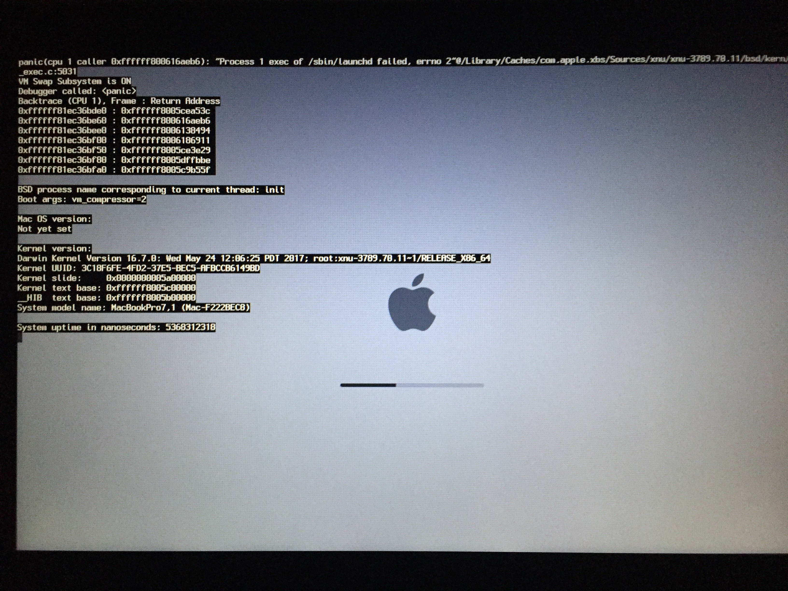

The install on my 2009 mbp with 1.2 TB fusion drive failed as well and went into kernel panic mode. On restart using Alt key I could select an install partition, when booting from there installation resumed. Let’s see if it works on the second try, otherwise I’ll have to go back to the backup.
– update :
Same on second try. Here a photo of the error:
-- 2nd update:
as suggested by @Lukeit I tried the restore via internet and installed from there, and this worked without an issue. I actually did not see this time an option to convert to APFS, and after the install finished I have an updated 10.13 system without apfs (maybe for the better for now :) ). It is working fine without issue. now the second beta is already showing up in the app store ...
