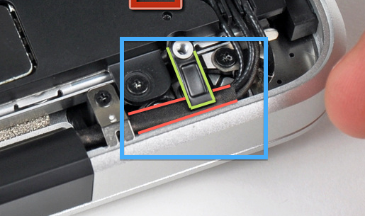

2) Locate the offending hinge:
3) Remove necessary hardware to remove this particular piece:
4) Take a small, thin piece of electrical tape (I had some black vinyl electrical tape lying around) and wrap about two layers around the "nose" of this piece. Wrap the tape around the "green box" making sure to cover up the tip edge of this piece.
5) Reinstall everything...
Essentially here is what happens...
Over time, the mesh that covers up airport/bluetooth/facetime cables begins to wear down due to constant abrasion against the sharp edge of the piece indicated above... The mesh begins to tear and begins to snag, which causes a loud "pop". Even barely moving, pressing on the top case, etc. can cause this bunch of wires to violently snap back into place. I.E. causing the audible snap sound...
