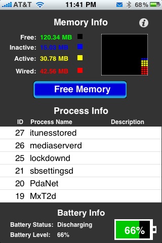

    I've been having some battery issues with 3.1.2 as well. There are times when my phone is just sitting idle and my battery will go down 1% every 20 minutes or so. I don't really have anything new installed that should drain the battery so I'm not sure what the culprit could be. I had downloaded the Auto-Lock toggle for sbsettings and had that running so I uninstalled it, but I can't see how a toggle would drain my battery.
    Is there any kind of battery monitor that can project how much battery life you have left depending on what's running? In other words, is there an app that can tell you how your battery life will be affected if you enable/disable/install/uninstall certain apps?

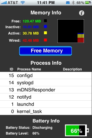

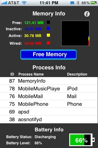

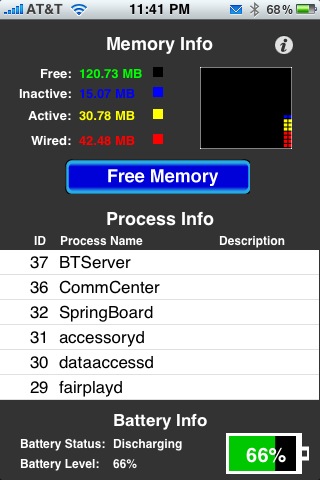

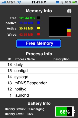

    Well it doesn't look like it was the auto-lock toggle that was causing my problem. I took my phone off the charger at 10:02 this morning and by 11:00am my battery was down to 96% even though it was idle the entire time - that falls pretty much right in line with what I posted last night. Troubleshooting issues like this is so difficult, but I'm hoping I can figure out the cause of the problem. I'm thinking that maybe my push gmail is the cause but I don't see anyone else reporting a problem with it. Anyway, these screenshots show what processes are running after a reboot - maybe one of you guys will see something in there that could cause the battery drainage.
