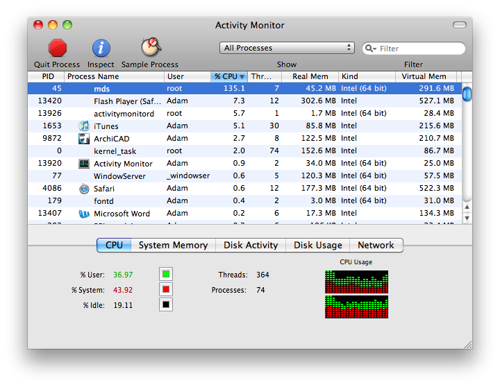

    Well ever since Snow Leopard I've noticed a dramatic decrease in speed and stability. Well the last 2 days I've been keeping the activity monitor open and noticing that a little process called "MDS" takes on average 90% of my CPU and Ram.
    Whats the problem here?
    Help would strongly be appreciated.
    Thanks.

    I have an external HDD that runs 24/7 and is plugged in 24/7. Other than that just occasional flash drives, and my cameras' memory cards.
    edit: MDS just pushed CPU % over 100. MDS is now taking 130% of my CPU....Wow.

    The 130% of your CPU means it's using 130% of the processing power of ONE core. Or basically it's using a full core and 1/3 of the other core, or a little under 70% of your real processing power.
    Which is nuts...
