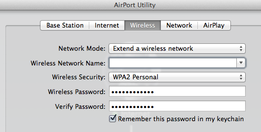

    Didn't spot the TC - this should work open the Airport Utility App and see if you can use the 'Extend a wireless network' in the network Mode. Then put the network name, choose the correct security and password and you should be away.
    This will expose your devices to the rest of the network, but I suspect that situation already exists, so the machine firewalls should be enabled (rather than just relying on anything in the router).

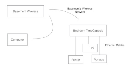

    So are you saying your TV can't connect with the internet, your vonage can't connect to the internet but you can see your printer from the computer. Are you physically connecting like this:
