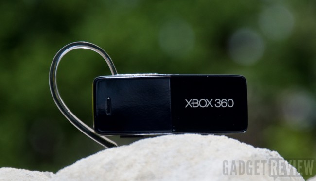

    How did they get the background so blurred was it through photoshop or was it the lens?

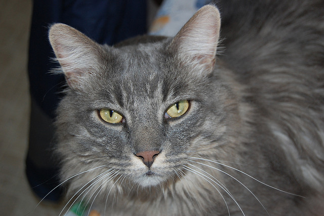

    This is the most I could get for a blurred background from my camera. The blurring was done through the focus points.

    Looks like pretty standard shallow depth of field to me. The typical result of a photo taken with a long focal length and a wide aperture.
    Edit: your cat photo wasn't showing when I first replied. If you want the kind of subject separation that you see in the photo of the XBox, you'll need a lens with a very wide maximum aperture, something like 100mm and f/2.

    Subject distance from the background + your distance from the subject all team up to make the top pic as blurry as it is.
    Your cat could have been taken at f/2.8, but because the other items are close to the cat, their details are more visible. The XBOX shot could have been taken at f/8, but because the BG is far away, it looks blurry.

    The Cat picture was not taken with a small point and shoot. The camera was Nikon d40.

    At what aperture? You need wide open to get those shallow DoF.

    55mm f/5.6

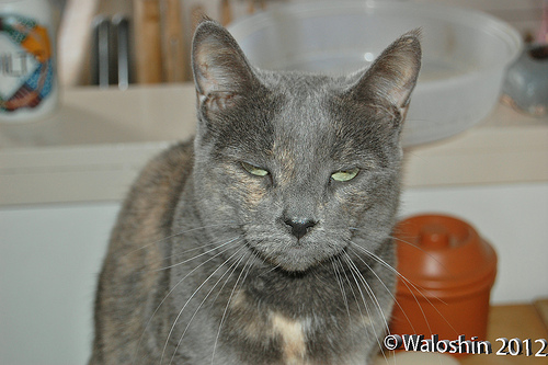

    And this one: [​IMG]
    At 35mm f/4.8

    PS Waloshin, your appear to be using the kit lens 18-55; which is a good all around lens but not a very fast lens f/3.5 at it's fastest and only at 18mm, at 50mm it's f/5.6. Do you have any other lenses? A 50mm f/1.8 is a nice fairly fast lens, a prime (usually sharper than a zoom) will give you more control over DoF.
