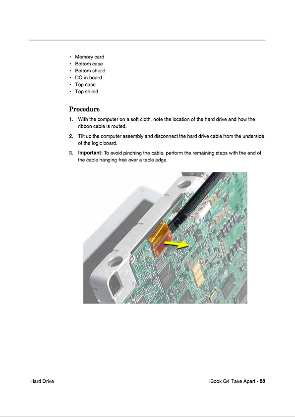

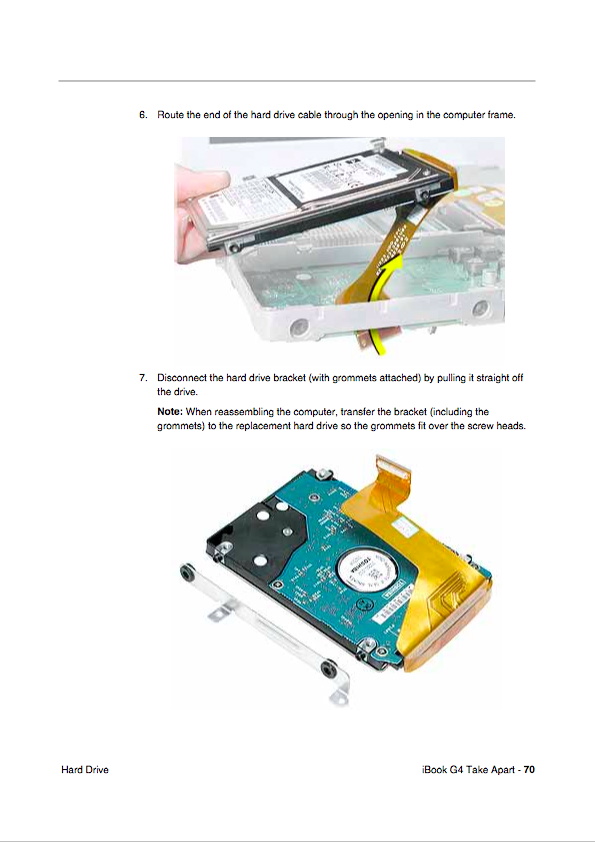

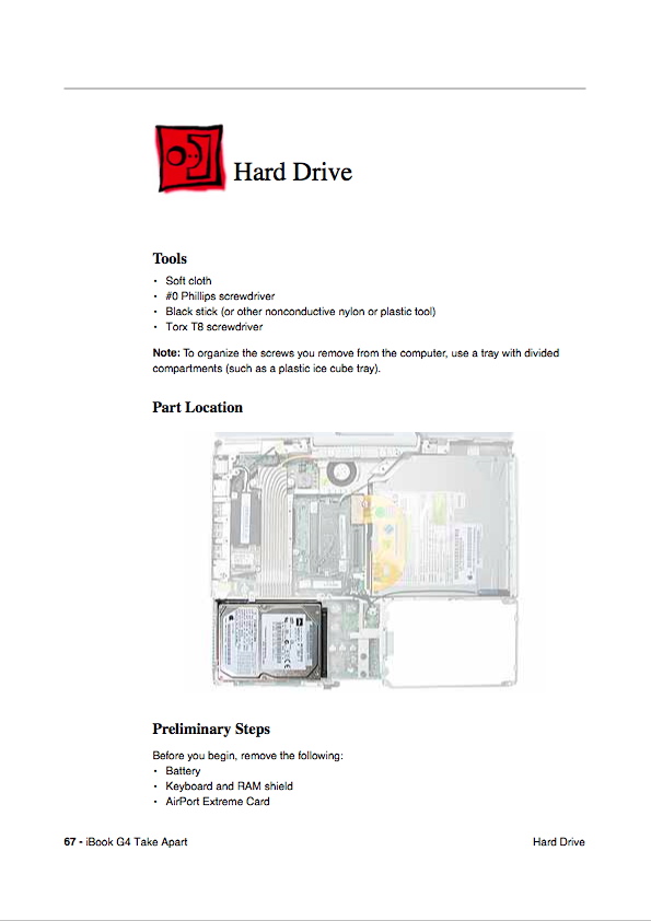

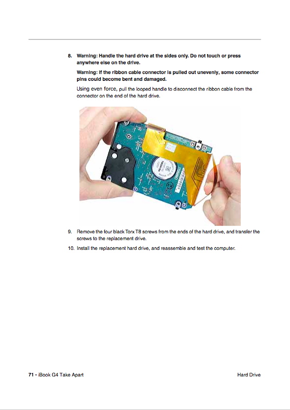

    Instructions for replacing HD in an iBook G4:

    Compared to replacing the HD on my clamshell iBook, that looks easy.
  23. Mitthrawnuruodo Moderator emeritus
    Mitthrawnuruodo
    Joined:
    Mar 10, 2004
    Location:
    Bergen, Norway
    #23
    Compared to replacing the HD in a Pismo (which I've done numerous times) it looks extremely complicated... ;)
    Edit: Remember before you get where these instruction start you'll have to "remove the following" (under Preliminary Steps):
    • Battery (two pages, trivial)
    • Keyboard and RAM shield (8 pages, the fiddeling starts)
    • AirPort Extreme Card (covered by the above)
    • Memory card (3 pages, trivial)
    • Bottom case (8 pages, looks pretty straight forward, but you need to be careful)
    • Bottom shield (4 pages, straight forward but again be careful)
    • DC-in board (3 pages, easy)
    • Top case (10 pages, pretty complicated)
    • Top shield (6 pages, 15 screws and a bit of fiddeling)
    Then, start with the instructions above, which is pretty straight forward...
    So, you basically have to tear the machine completely apart. I wouldn't do it myself, at least with an iBook under warranty... ;)
    (Anyone interested in me posting the above mentioned instructions...? It'll take a few minutes and quite a few posts, but I could do it...)
