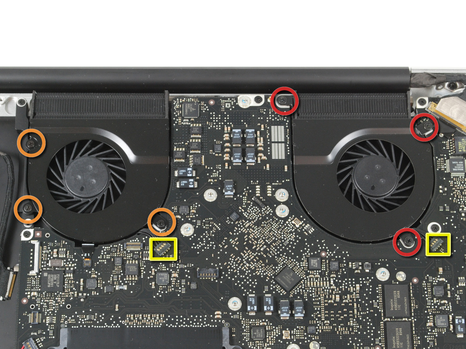

    There's a solid sheet under the keyboard, preventing any meaningful airflow. The fans, intake and exhaust are all located near the hinge, close to the primary furnaces, the CPU and GPU. This basic layout is essentially the same for all Apple notebooks.
    [​IMG] [​IMG]

    Heat radiates through the keyboard just like it does through the solid base, but neither is used for heat venting. All venting that is required to keep the notebook cool is located at the rear, near the hinge. I'm sure you know by now that not everyone who posts in a forum knows what they're talking about.
