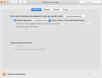

I arranged an old 2010 MacMini as a music server with an app which I can control over my mobile phone but even tho I set the Mini not to ask for a password each and every day I try and use it to play music with the player active it doesn't unless I perform remote access off another computer (it runs headless connected to a TV via HDMI just in case).
Weird is that I removed the password to avoid entering it each and every time but if I wanna remotely access it with file sharing I get asked for password but it doesn't allow me, if I go through screen sharing it then works...

I think you got me the right hint, a panel I never gave any attention before, this preference pane where user get asked to type the password after either stop or screensaver activation, since I had no password inserted I had to first input one then being able to disable the request in the pane, tomorrow we'll figure it out.
