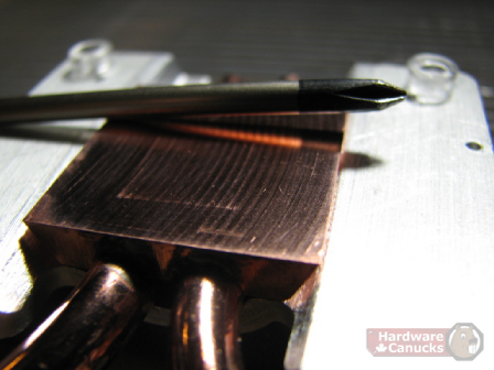

    Yes, ideally you should clean it off with acetone and reapply a new layer. if you got finger oils in it then it may run a little hotted than normal. Same for particulate matter. You want super clean surfaces on both chip and plate and you want the thermal paste as uncontaminated as possible.
    How much difference will a finger touch make? Probably not much. At first maybe 0C ~ 5C difference. In 6 months to a year later; potentially 1C ~ 10C difference. Or it could be none at all depending. :) But it's better imo to be a little meticulous about these things. SilverFox thermal conductant is pretty cheap I think. $5.00 ? And another $0.50 worth of acetone.
    Also by looking at this shot:
    [​IMG]
    I think I would use some polishing compound on it too. Mirror surfaces tend to conduct better than something like this.
