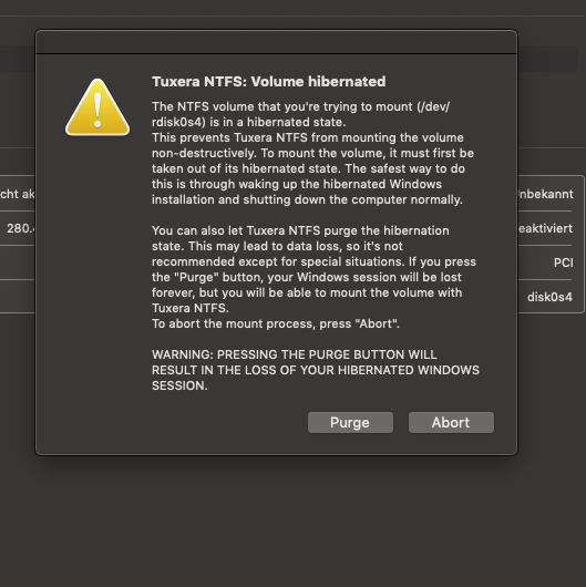

When starting Mojave the Bootcamp volume is grayed out. When traying to activate it through disk Utility I receive a message it is hibernated. I cannot write in it or change anything. I use Tuxera NTFS. Any help will be very wellcome.

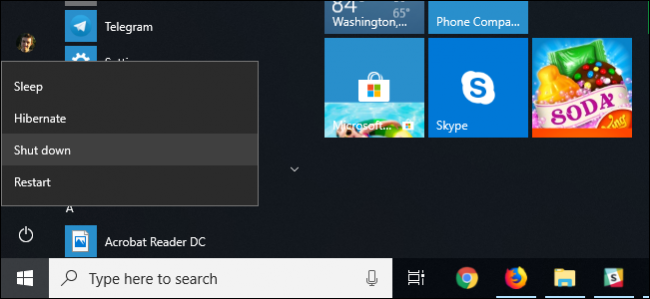

You need to go back to Bootcamp and make sure that you shut down Windows rather than put it to sleep or hibernate it, just as the Tuxera dialog says.
