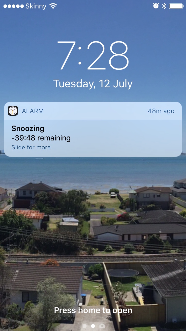

I had setup my wake up alarm by using the new bedtime tab in the clock app. I woke up this morning but I like to snooze for a couple of more minutes so I pressed the snooze button. However I can't seem to dismiss the snooze notifications on my lock screen. I have multiple of them because when I hit the snooze button it wouldn't dismiss it. Either pressings on it and choosing to dismiss it or swiping to delete from my lock screen do nothing. Now they are counting down even to negative numbers. Does anyone figured out how to dismiss them successfully?

My snooze has continued counting down past zero today...

I had to revert back to iOS 9 but I managed to get rid of it by rebooting the phone. Hope it helps.

I was hoping this was fixed in beta 2. I was wrong. I've been restarting my iPhone every morning. For me it's no hassle but for others it can be the breaking point of iOS 10 beta

My work around is to keep snoozing until you are fully ready to wake up then press stop. Basically do not try to stop the snooze earlier. I set my alarm for around 5ish in the am, snooze 3 times, the final time I wake up, I press stop. No more negative snooze on the lockscreen.

I encountered this very same issue on Monday. I had both my regular and alarm and "bedtime" alarm set to go off at 6:45am. I could not for life of me get the snooze to work. Ultimately I disabled "bedtime" tab and just relied on my normal alarm within the app and it has been fine the past two mornings.
