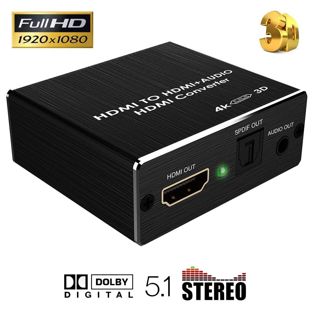

When you have an HDMI cable attached, the sound AND the video is routed through it. Because your monitor does not have speakers you will not get any sound. You'll need one of those HDMI break-out boxes that will pass the video through the HDMI to the monitor but offer a 3.5mm audio out to attach to speakers.

If you want a more reliable option, I recommend this adapter that I just bought myself for this very reason...
https://www.amazon.com/gp/product/B076MNY1RD/
I prefer this over doing the dongle-shuffle because it allows me to hook up ANY device with an HDMI output to my monitor and allow audio.

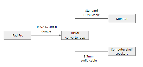

Thanks for this. So, sorry to be dense, but how does this connect to the iPad? You still need some sort of dongle, no?
No worries. Yes, you'll still need the dongle. USB-C to HDMI. You'll need to connect a standard HDMI cable from the converter to the monitor for video. Typical computer speakers are self-powered and have a 3.5mm audio cable that would be plugged into the audio out of the converter box.
As I mentioned previously, I like this setup (though it requires that $20 HDMI converter box) because I can connect ANY device with an HDMI out to that converter box. I use this setup to connect a BluRay disc player, XBox, Playstation, etc.
Ah, ok, got it, thanks. So, this solution still wouldn’t allow audio to play out of the onboard iPad speakers when hooked up to HDMI, but it would allow for external, wired speakers/headphones.
