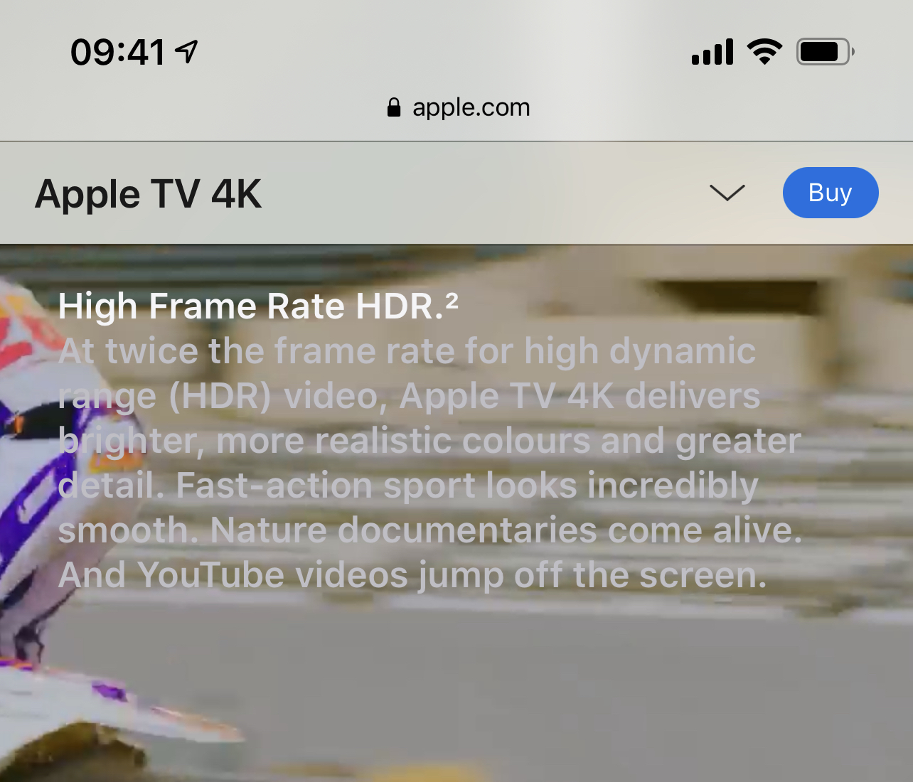

All the marketing just says 4K YouTube. Can you point to any marketing that suggests the new ATV supports HDR in YouTube?
Says so on the Apple TV 4K info page
