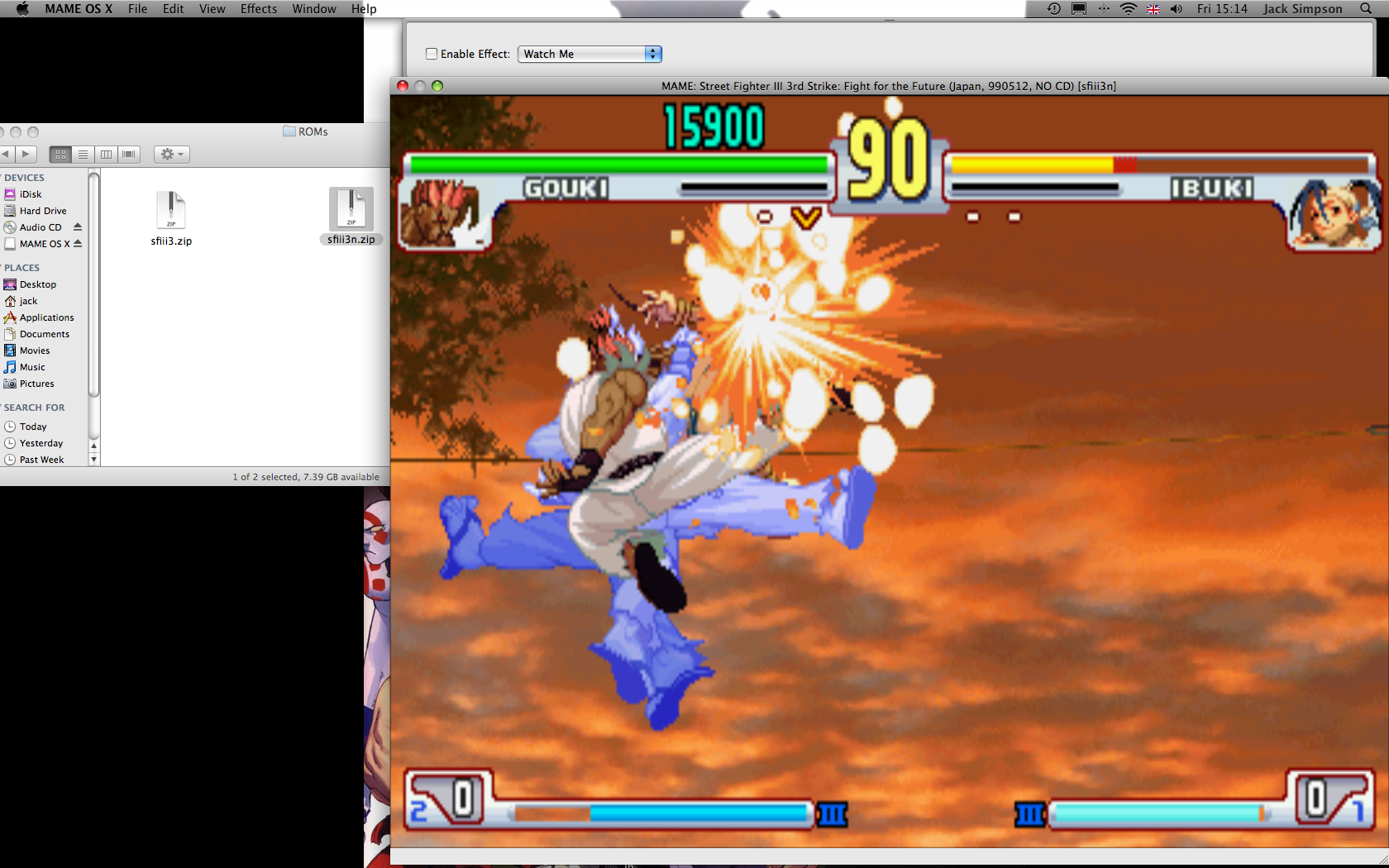

    Alright guys massive update. I managed to get it to work! I think it was just the version compatibilities that were stopping me before. I shouldn't have tryed to download the USA version. Instead I downloaded the Japanese version(makes no difference in a fighting game). It works flawlessly.
    I think you only need CHD's if the file required an original CD to run it on the CPS3 machine. The Japanese version says "No CD" which I guess is why I did not need a CHD file.
