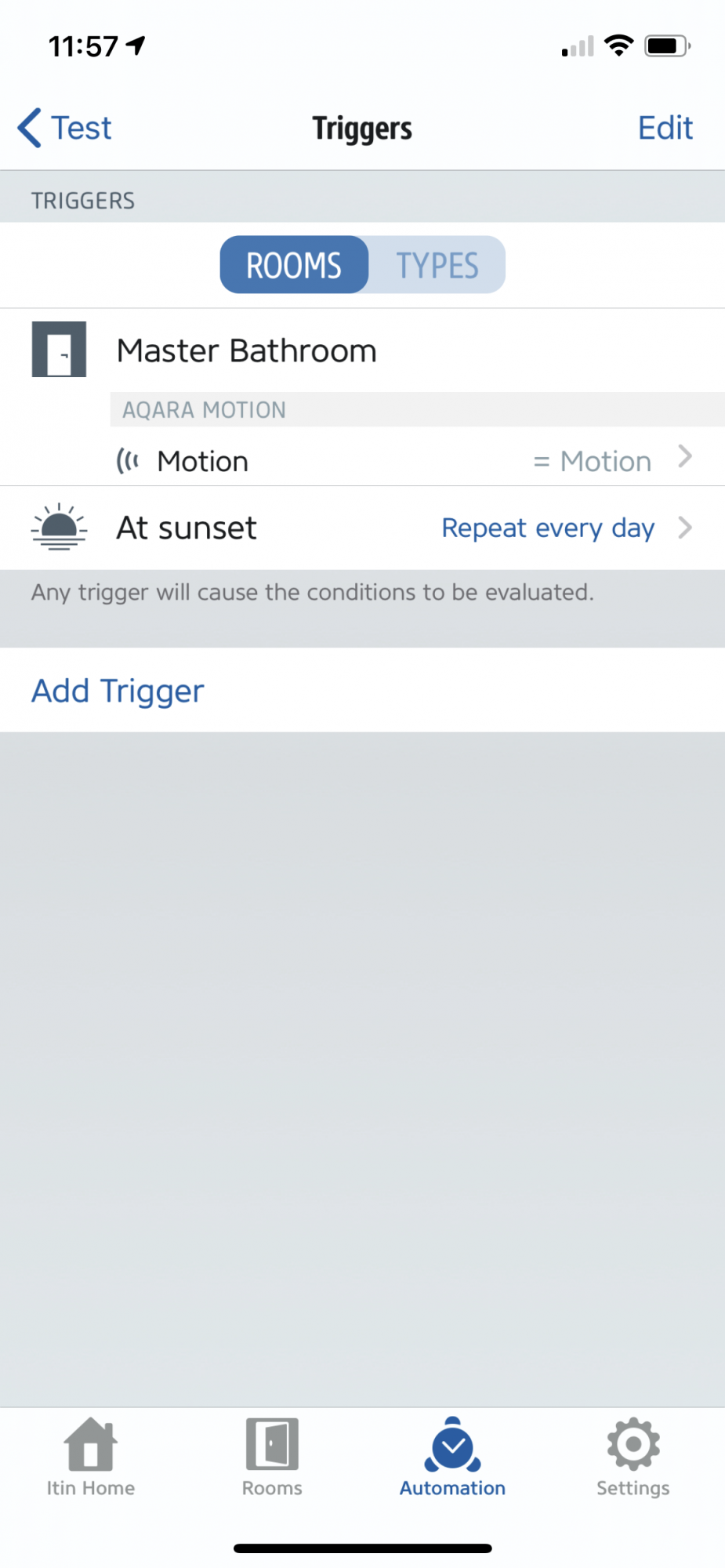

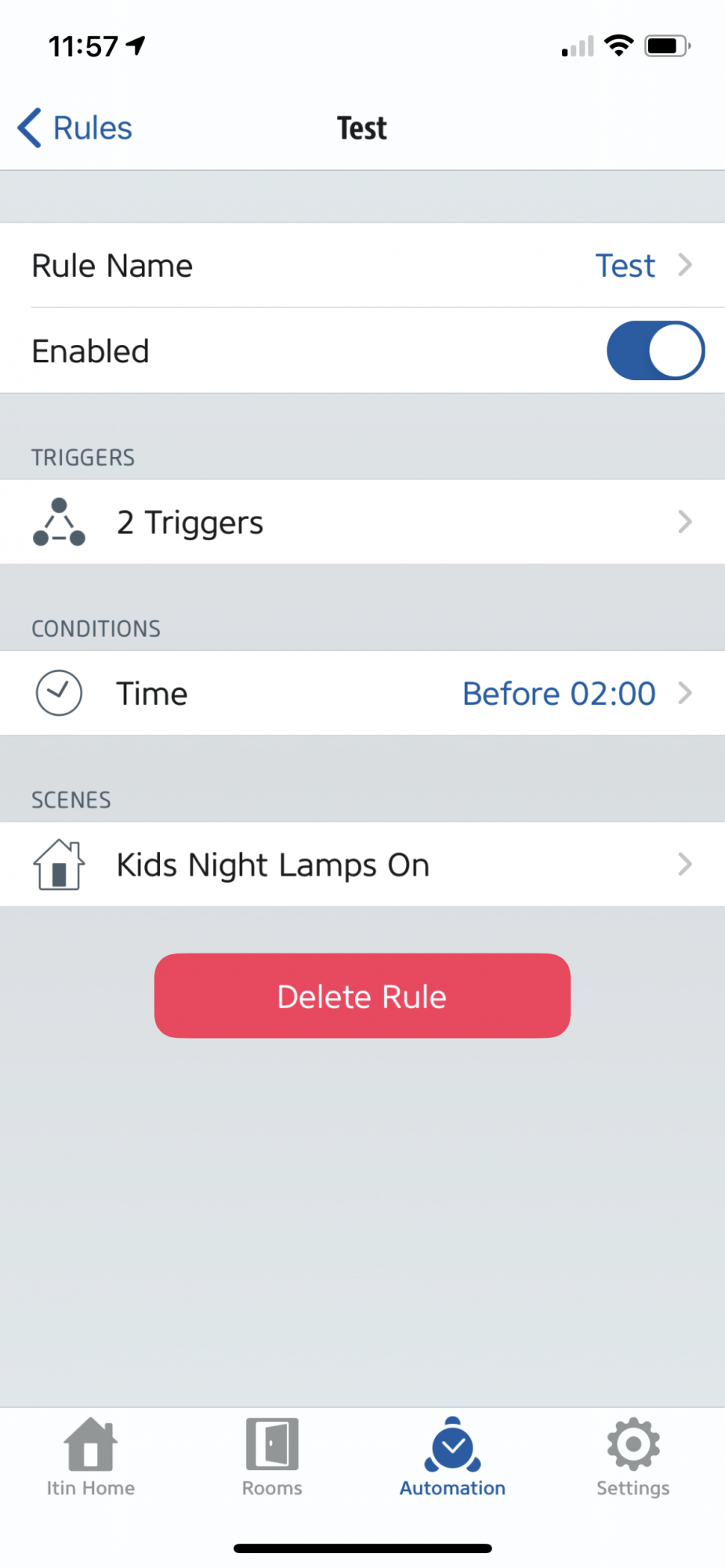

How did you do it? I haven’t tested it yet but I just created a test automation in the Eve app. I set a trigger as sunset and when motion is detected in one of my rooms and set a condition if before 2 am. I didn’t get an error message or does the error come when it tries to fire the automation?

I might be wrong, since I'm a beginner with automations but it looks like you have 2 triggers. So it would even trigger when it's just sunset (even when there's no motion), right? What I tried to do (and this is where the message showed up) is to set up 2 conditions (after sunset + before 2 am) with just 1 trigger (motion).

Ah I see. My mistake. I though it was an “and” trigger, not an “or”. Let me check the Controller app. Pretty sure I saw that you can select “if all” or “if any” condition is met. Maybe shortcuts would work too. Let me do some digging.
