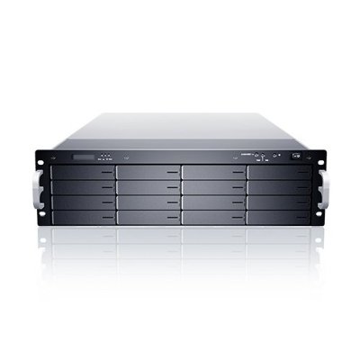

    I'm actually looking into the Norco 4220. It's only $299 and it can hold 20 Hot-Swappable SATA/SAS Drives.

    I'm looking into getting an Atom based Motherboard with a 560 watt 45-50 amp Powersupply. And then I would need to get PCI Express SAS/SATA Raid cards.

    A couple of unraids (perhaps using that Norco box(es))? That can be fairly cheap compared to other solutions listed here, and is pretty good for media storage. Expand it as you need it without rebuilds.

    Just for some comparison, I have a norco 2208, a 500w psu, and an i3 2.93ghz. Although I havent really come close to maxing out the i3, I would let an Atom run that big of a storage array. I have the Highpoint 2720 card which supports up to 8 6GB/s SAS/SATA drives but you'd need to either get a few of them, or just one card that supports 20 drives. Check out the 2760
