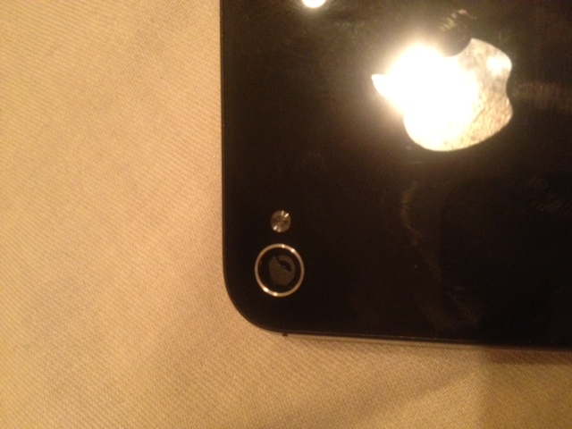

    My iPhone 4s needs to go to be repaired as there is a problem with a piece of the phone having slid out of place and is now covering the camera lens. :mad:

    You can see something has slipped out of pace here and is covering the lens!

    You won't need a new iPhone. That's the little rubber lens protector (imagine a square sticky foam pad with a circle cut out, to stop the camera lens hitting the back cover).
    They probably wont even need any parts - it'll just be a case of repositioning the one you have (it it's under warranty, ask them to put a new camera in which will come with a new foam pad). They'll have the bits to do this in store (they stock back covers and cameras (the foam comes with the camera service part), and can do this within about 3 minutes :).
    If you're out of warranty, the camera module is £26.54 - not sure what it equates to in Euros though.

    Heck, you could even buy a small pentalobe screwdriver for $2, slide the back off, and move the rubber yourself :p

    I actually have the tools to open the phone — I didn't really want to go down that route as it is still in warranty but it is looking like that may be the way forward for me now!
