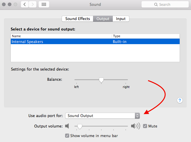

You can go into System Preferences > Sound and then go into Output. When you're using the extender, without anything set, "Use audio port for" to "Sound Input" and when you're using headphone, to "Sound Output".
Might be able to make it a one button thing with AppleScript.
GGJstudios
macrumors Westmere
May 16, 2008
44,428
796
Where is that setting? No such setting appears on Mavericks.

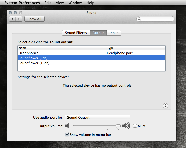

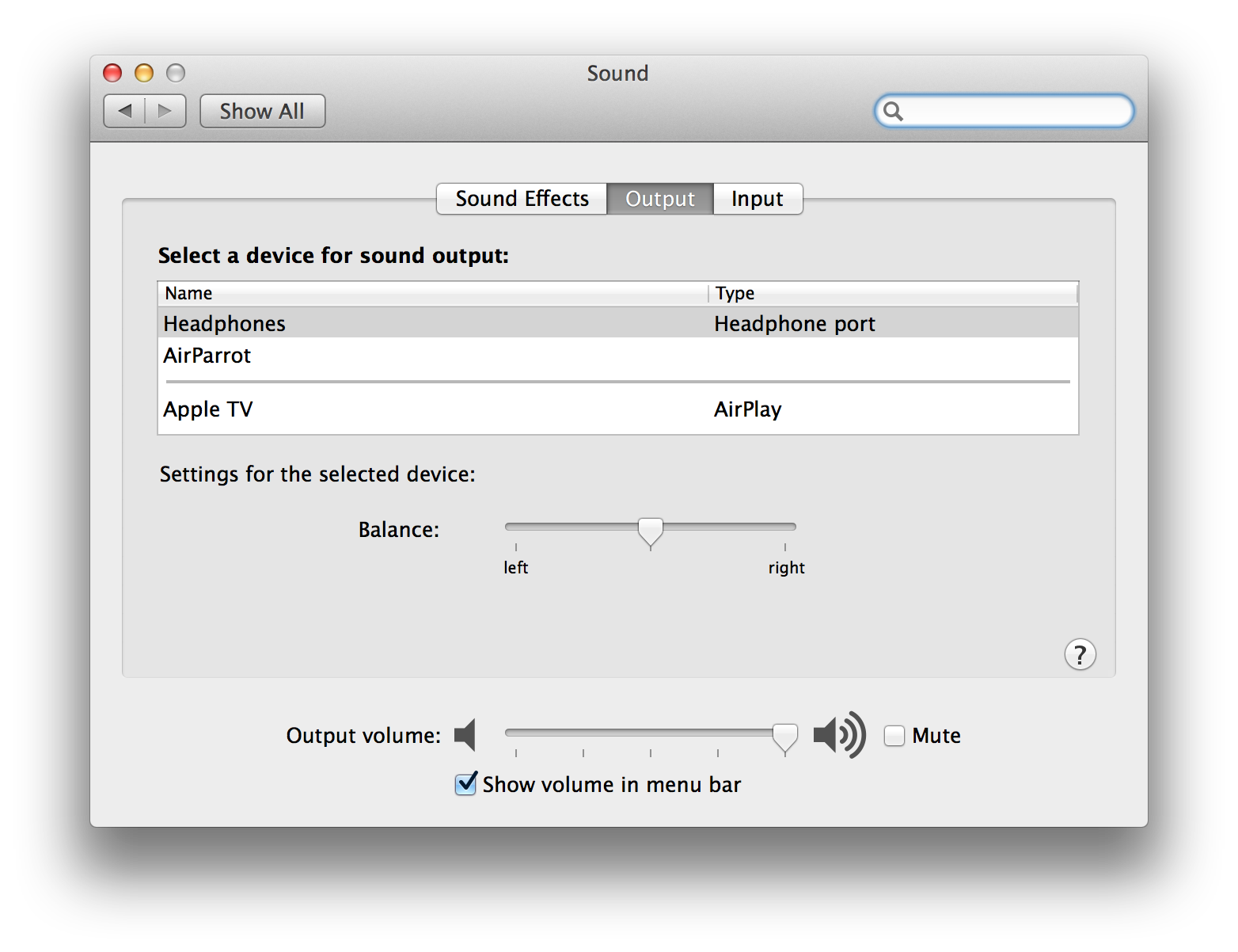

Quote:
Originally Posted by Jessica Lares View Post
I am pretty sure this isn't new to Yosemite. I am positive that I was messing with this in Leopard.
Attachment 524843
Interesting. It's not here in Mavericks:
Attachment 524844
not shown in mine either it shows that same as GGJstudios

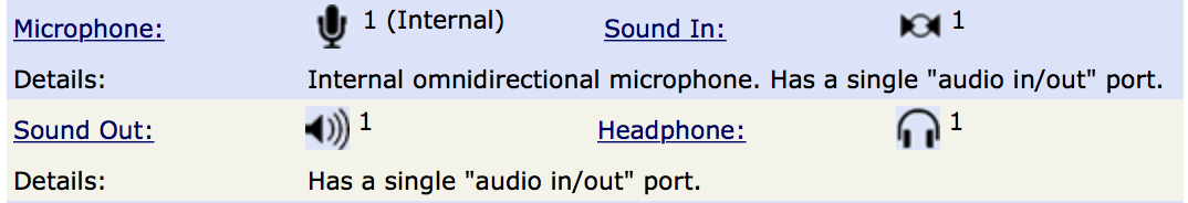

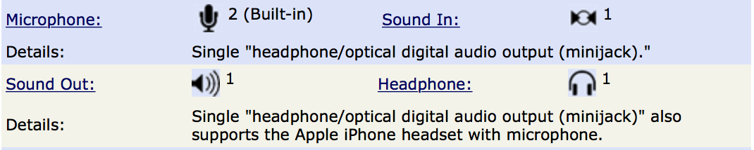

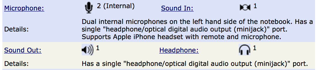

Hmm, found a screenshot here:
After some digging, it appears the difference lies in the audio port differences between your MBP model and the iMac and MBP the OP and I are using.
OS X Yosemite: If you can’t hear sound from your speakers
If your computer has only one audio port, choose Sound Output from the “Use audio port for” menu, then make sure your external speakers are selected.
The OP's iMac:
My MBP:
Your MBP (processor may be different):
