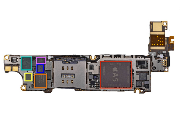

They made it smaller so that they can fit more actual hardware inside the phone. They have a point; there's really no use for the extra plastic around the actual contact area.

Well it's not about just 'sticking in' a new tray and that's it. A lot of extra work has to be done to make the phone seek out and maintain two different signals on two different SIM cards.

Lmfao pardon? The Nano Sim is underneath 'Authorised Service Provider Only' and there's barely enough room for that. Why would we go back to MicroSim?!
I know exactly where it is. And I design PCB's for a living.
I never stated we would 'go back to micro-sim'. I simply stated that it wasn't a necessary change (micro to nano) from a design standpoint.
I believe the decision was made from a business standpoint. Hell, Apple originally wanted a software emulated sim standard in this version of the iPhone. Luckily, some committee had the sense to shoot that idea down.
Again, no, it wouldn't fit in the layout of the iPhone 5.
I take it you have never compared the two assemblies. (not just the tray, the entire assembly)
If you get a chance, I would recommend you look at them. The differences are minimal at best.
This would have been well within the tight design tolerances of this phone.
Does Forbes satisfy your need?

Minimal makes all the difference in the world. I don't know that the hell you design but you're obviously uneducated in the matter if you think the switch to nano-SIM wasn't to save space.
Linking to some guy's opinion on some website doesn't matter.
The source was to show apple had considered a software based sim solution.
I guess 2 masters' degrees (business and engineering) shows the magnitude of my un-education.
The business side of this could have been to satiate the appetites of carriers who wish to keep selling phones that are locked and under contract. The inconvenience raises the switching cost to the prepaid competition.

What a fallacious way of arguing. Nobody cares about your minor scholastic achievements. You're still being daft and trying to argue that the nano-SIM doesn't save any space. I really don't know why I'm bothering but I really invite you to take a look at the size differences of the internals, taking thickness as well into account. Even if it's a single millimeter, it's a step worth taking.
Now go ahead and tell me about your masters and how 40% smaller isn't smaller.
Ok, once again. I will break this down so it is easier for you.
1. I never claimed it didn't save any space, I claimed the space savings was not necessary.
2. Space saving can be advantageous; especially when dealing with heat mitigation. (this is a more likely reason versus the 'not enough space' argument)
3. 40% smaller is the card size, the entire sim assembly (what the tray goes into) is not much smaller at all.
4. A micro-sim assembly would have certainly fit in place of the nano-sim assembly.
You are the person that brought up my education. You brought up the herring fallacy. I simply countered it by stating some of my educational achievements.
1- The savings contributed to allowing the device to be as thin and light as it is, regardless of the scale of the contribution.
2- So..now you're arguing that it was good to save space. Ok so we're on the same page.
3- Not much smaller, but smaller enough to make a difference. The SIM shrinkage is there. Now they have to apply the same effort to shrinking the assembly to save more space. The SIM tray itself is significantly smaller.
4- Nope. It's significantly smaller and thinner. I really invite you to accept your own invitation: just take a look at two phones with their backs off.
iPhone 4S
dCidpYqpnbZ2JiDS.medium
iPhone 5
If you really don't see the size savings here, there's not much more I can do for you. Best of luck.
