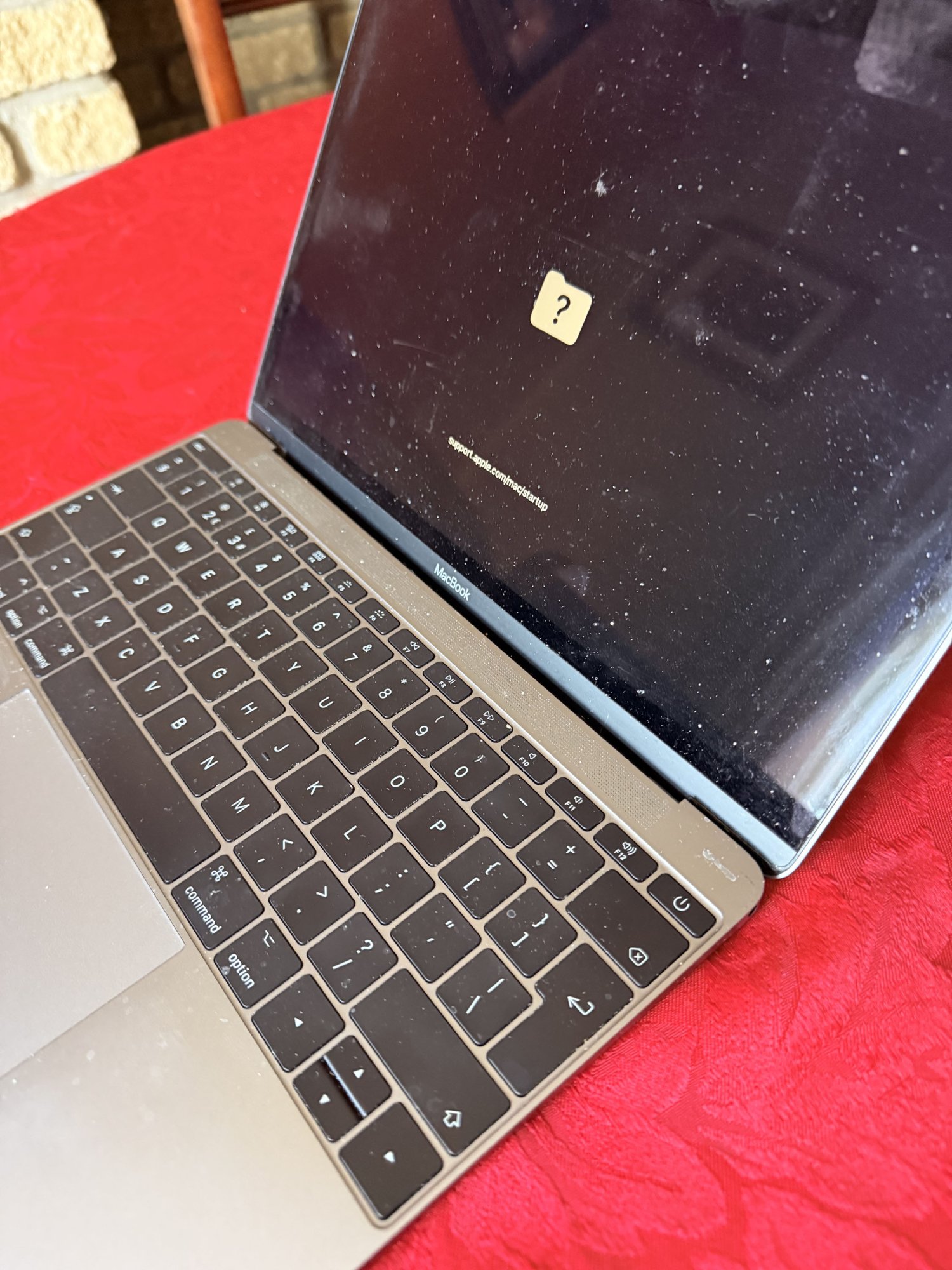

I am currently working on my elderly father‘s 2017 MacBook. I don’t know precisely which model it is, but it only has a USBc socket and no USB. I was getting the start-up screen with the folder with the question mark (?) In the middle but it would occasionally reboot properly. I was then able to download Ventura which failed to install. I did that by going into “this Mac” and going to software update (Ventura) was listed. This was running High Sierra or Big Sur (can’t remember).

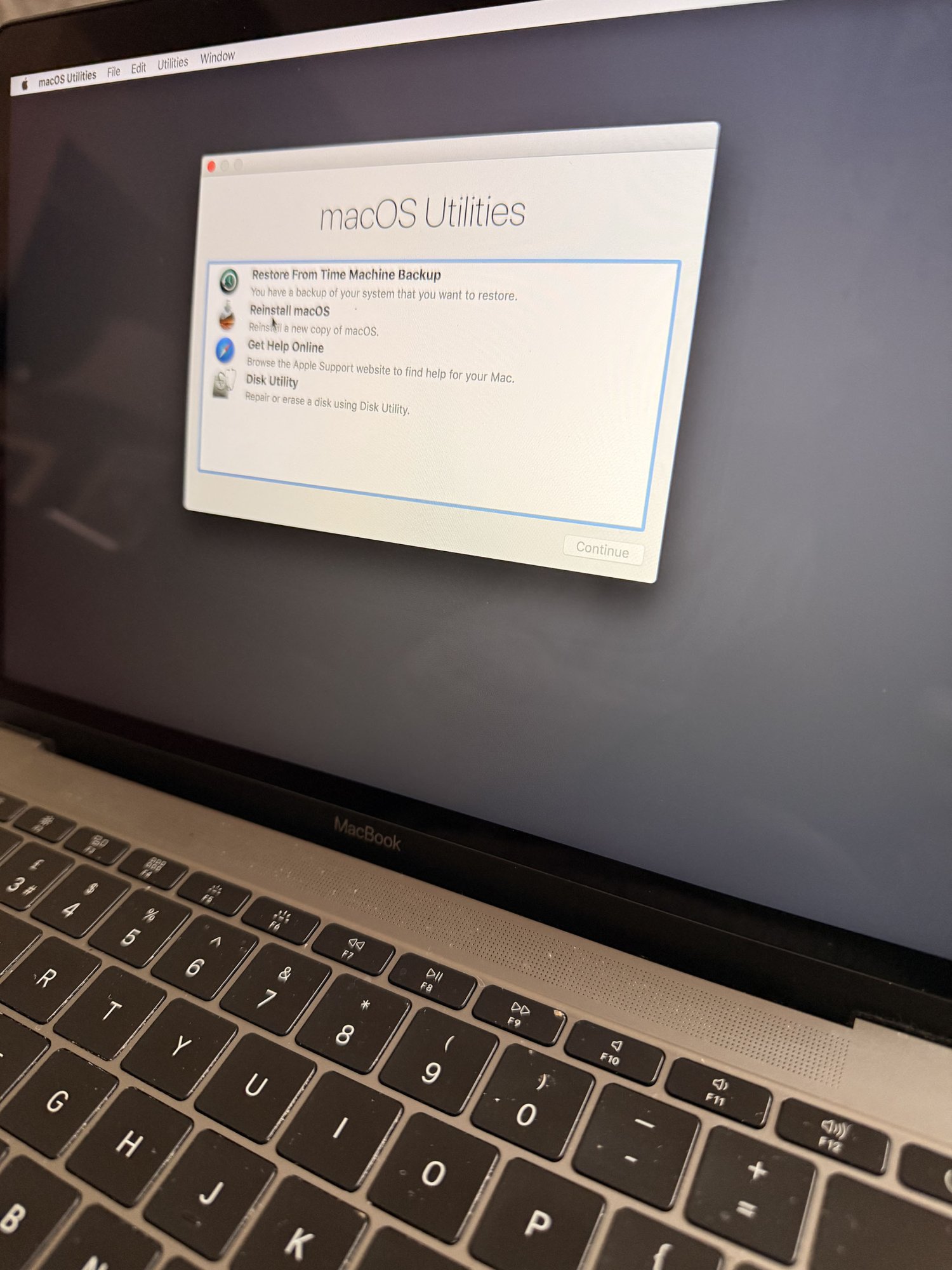

I have been using command R to get into MacOS utilities which has four options. (option 1) is restore from Time Machine backup. He has never run a Time Machine back up so cannot do that

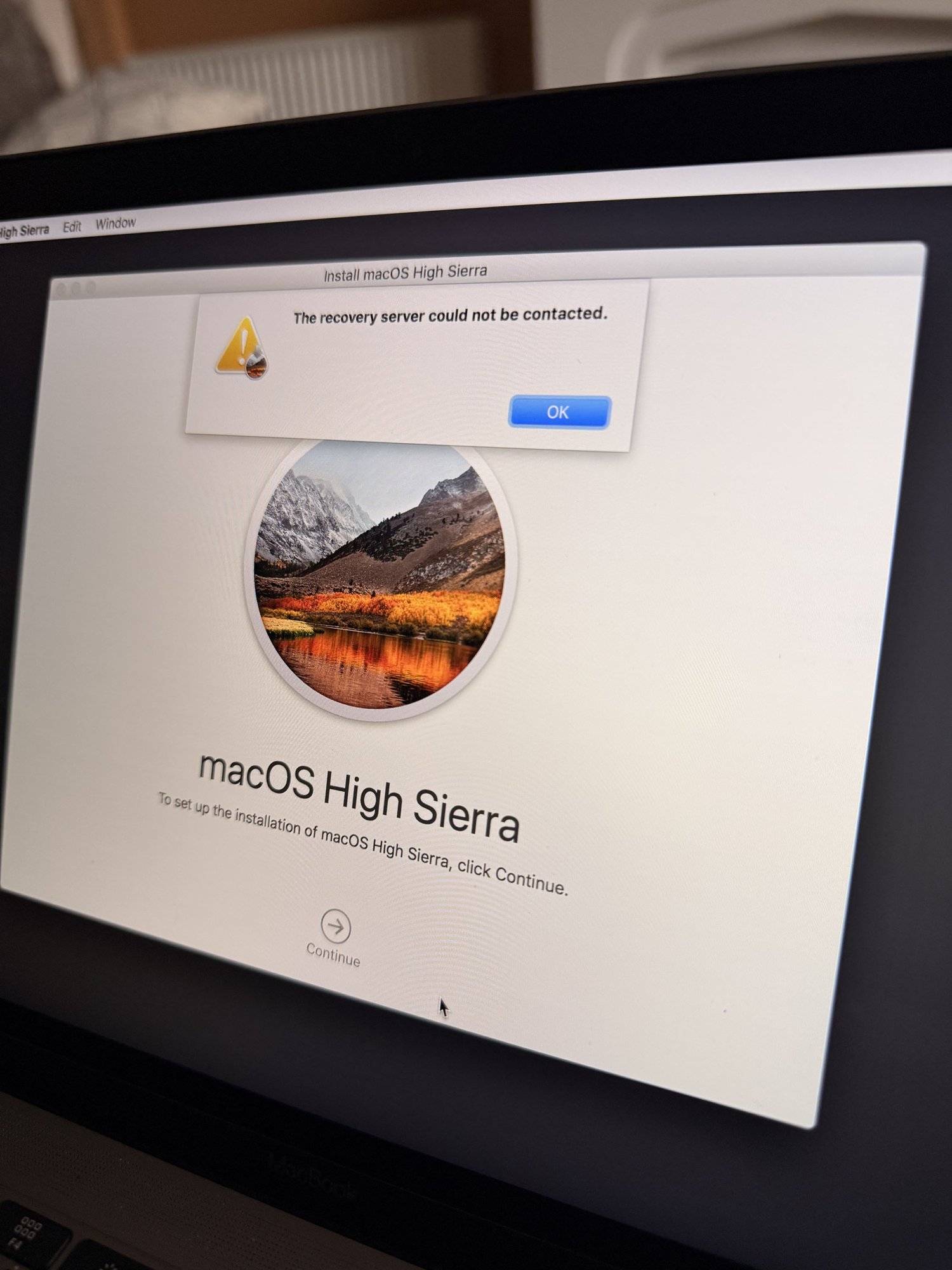

Action two is reinstall macOS which I assume is downloaded from the Internet. When going into that option, it comes up with the insulation box for high sierra. When doing that, I get an error message which is. “The recovery server could not be contacted”
The third option is get help online, but all that is is instructions of how to get online
The forth is disk utility. I have run a health check which has not thrown up any errors.

I have same MacBook. Use Option+Command+R is Internet Recovery which will provide install for latest macOS compatible with your MacBook. Recommend you get a USB-C hub with power pass through
https://www.amazon.com/dp/B0D1XLNWP2
and USB-C Ethernet adapter
Internet Recovery has worked flawlessly using hardwired Ethernet attached to hub, MacBook power attached to hub, and hub attached to MacBook.
It’s not my MacBook, so don’t particularly want to buy a bit of kit. Is the install failing because of using WiFi, then?
Most likely. The hub and Ethernet adapter should be standard in any troubleshooting “kit” for modern Mac laptops.
