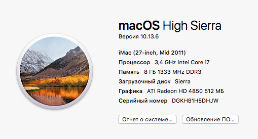

Hello everyone! There is a problem connecting the iMac 2011, it has a video card from 2009 ATI Radeon HD 4850 512, I connect it with a Mini DisplayPort to DisplayPort cable to a Windows PC, should this work? The cable supports resolutions up to 8K, the ports are working, is it a problem with the cable or is there fine tuning? on the other end there is Windows 10 with an RTX 3060 12gb i3 9100 z390 a-pro video card.
The task is to connect as a second monitor to the Windows PC )))
Cable Mini DisplayPort DisplayPort v1.3 8K 30 Hz/Length 1.8 meters/Belsis/ MiniDP DP 8K@30 Hz/5K@60 Hz/4K@120 Hz/2K@144 Hz/ 2K @165 Hz/1080P/BW8806
Is the problem in the GPU or the cable?!!!

Please help me understand. You have an iMac 27" 12,2 with a HD 4850 installed (like the image above suggests)? I'm being told that is impossible to put a 2009 HD4850 in a 2011. Still, I am trying to install this graphics card in my iMac 12,2 and I cannot get it to boot properly into the macOS High Sierra. Currently, I can only boot into safe mode where the card shows as installed correctly just like your image above.
To perhaps help you with your question, external displays will utilize the graphics capabilities of the GPU and the HD 4850 could be limited by drivers you have loaded. macOS High Sierra should have all the necessary drivers (KEXTS) for the ATI (AMD) 4000 series graphics cards, but there could be something missing that is causing your problem.
