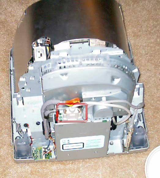

    Uh which connector am I supposed to unplug?

    This one is the internal monitor connector. This is where I plugged in an external. If you don't have an old apple monitor you should be able to find a cheap (pre ADC) mac to vga adapter.
