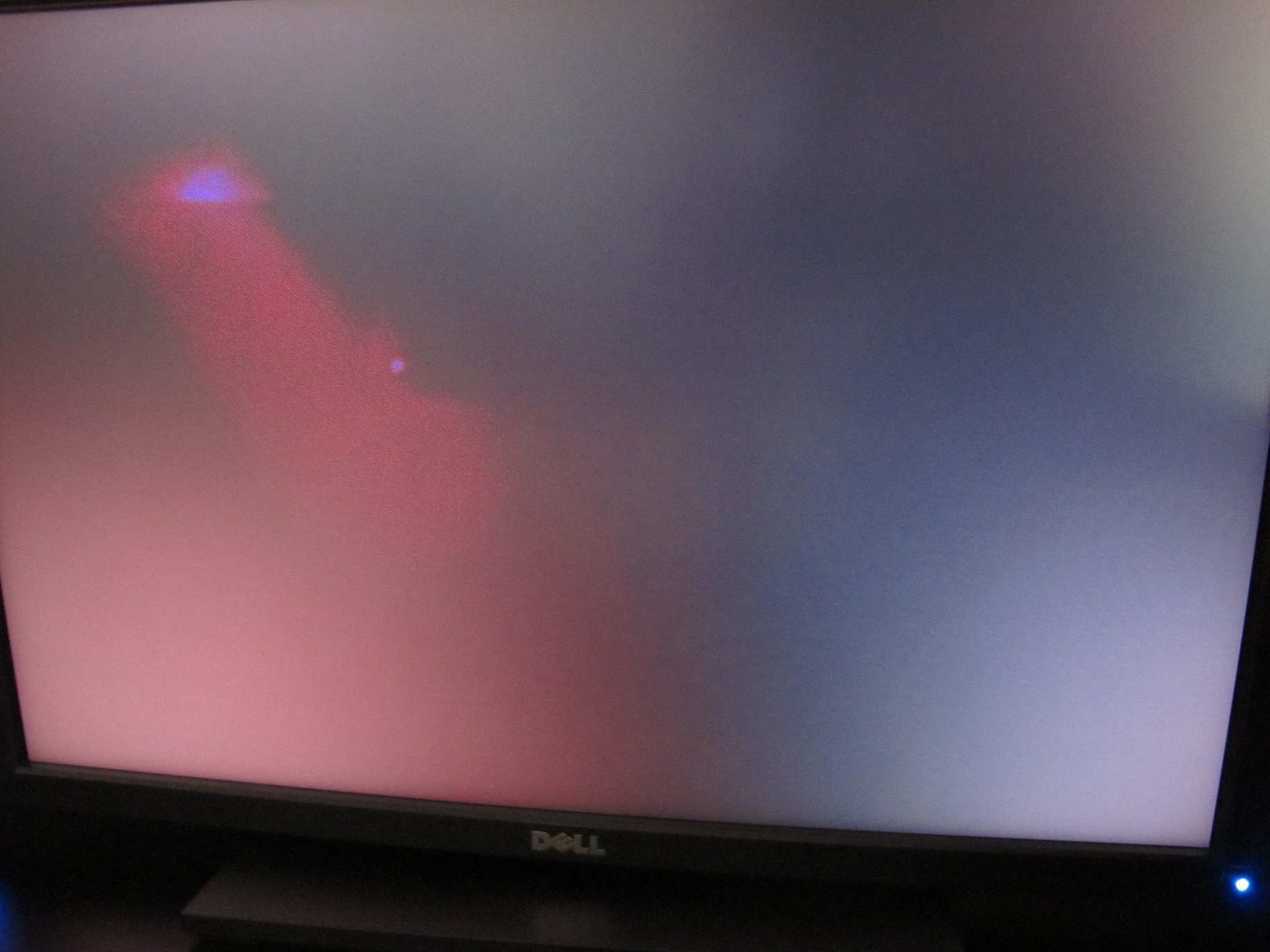

    I'm pretty sure it's a specific frame from a fluid screensaver. I've never seen the screensaver just stuck on the screen, it's always moving. Here's a couple pictures. Actually, it maybe looks like a split frame or something:

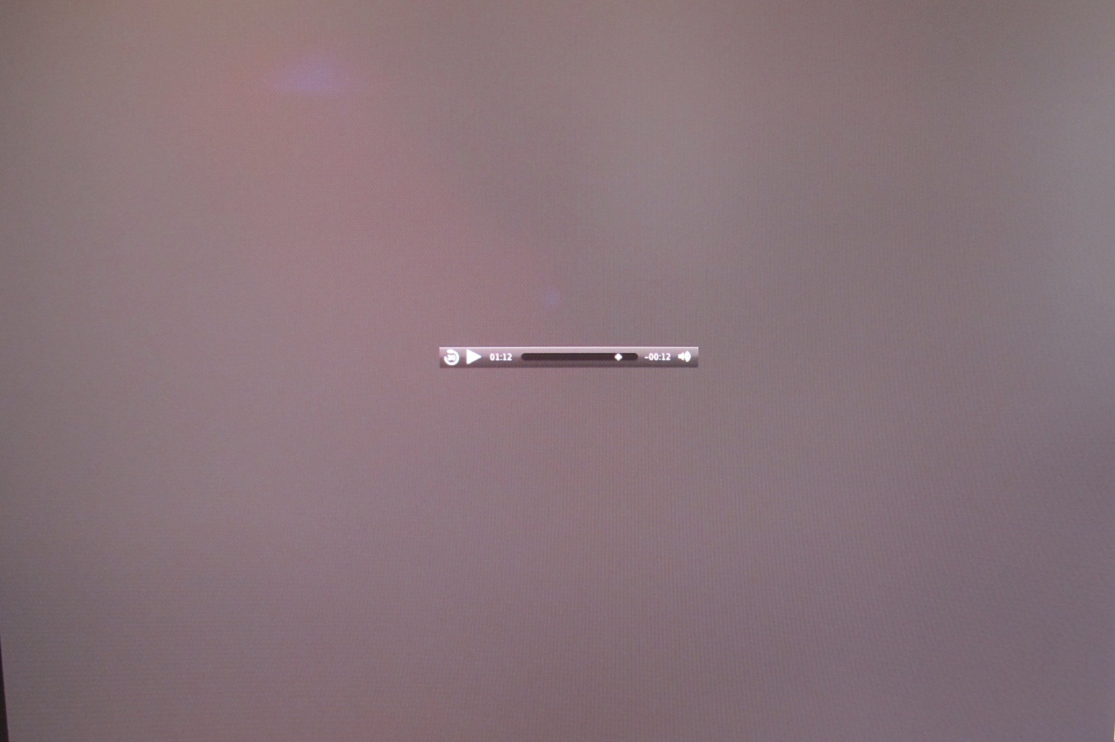

    this picture makes it look worse than it is, the camera made everything brighter and glossy. In reality, the whole screen is dark/black, with the colors in the upper left being the noticeable "burned image". Here's an example of being able to see it on a grey background:
    but in most other images/applications it's unnoticeable.

    edit: mkrishnan -- yep it's an LCD, Dell U2410, which is also why I find it hard to believe. I'll try that pixel fix though.
