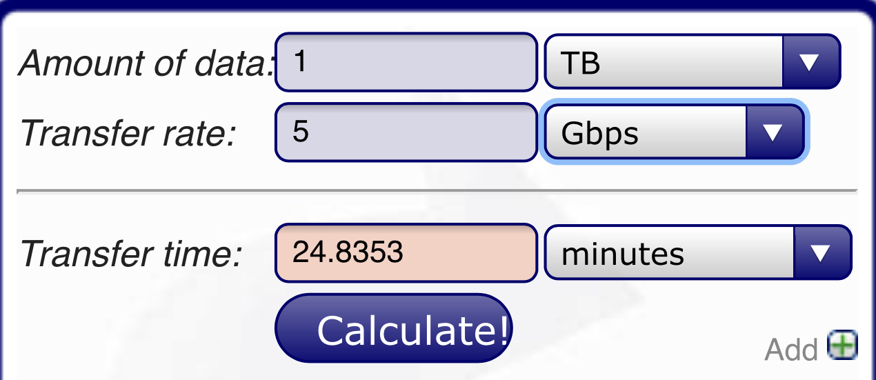

If you’re using USB-C, which transfers data at a rate of 5GB/Second, you could look at a Estimated time of:
5-25 Minutes. This varies a lot, depending on what Hardware you have.
Hope this Helps.
Your math is off by at least a factor of 5.
5GB per second is way beyond any USB protocol.
Reactions: DiamondarBoss
Oops, my bad.
It’s 5 Gigabits per Second, not Gigabytes. In that case to transfer 1 Terabyte of Data it would take about:
25 Minutes.
Sorry About that.
