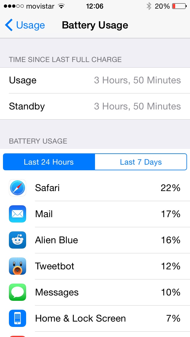

In less than 4 hours of full use my iPhone 5 battery has decreased to 20%. Is it in t
Discussion in 'iPhone' started by iRock1, Mar 10, 2015.
  1. iRock1 macrumors 6502a
    iRock1
    Joined:
    Apr 23, 2011
    #1
    I have to clarify that it's far from being a new phone. As a matter of fact it has a couple of years I think, but still.
    The battery performance has decreased notably with the latest iterations of iOS, I think. Is this in the "normal" crappy range of battery life of the iPhone or would you say there's something wrong?

    The fact that usage time is exactly the same as standby time generally means there's some process that's stuck or running all the time, neither of which should be the case, and that's usually behind something like a much higher battery drain. Between restarting the phone and resetting network settings or all settings perhaps you might be able to resolve that, unless perhaps a whole restore as new might be in order, which is possible.

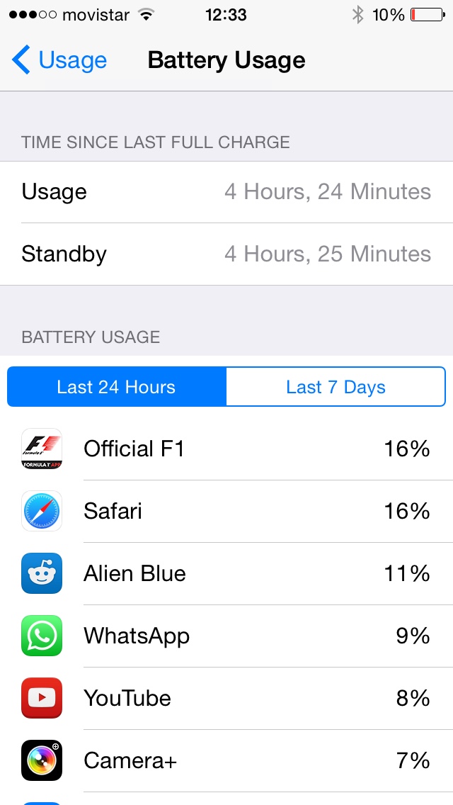

    In the meantime, have a look at my sad new record: down to 10% in just 4 hours 25 minutes.

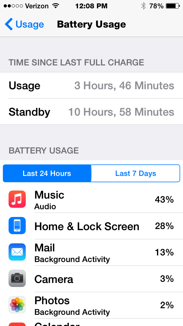

    My 5S running 8.2

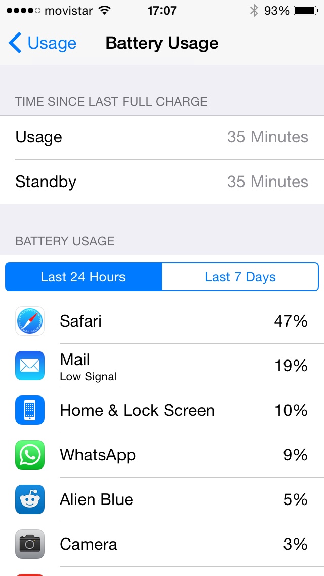

    Latest test, after disabling background refresh:
    As you can see, it looks like not much has changed.
