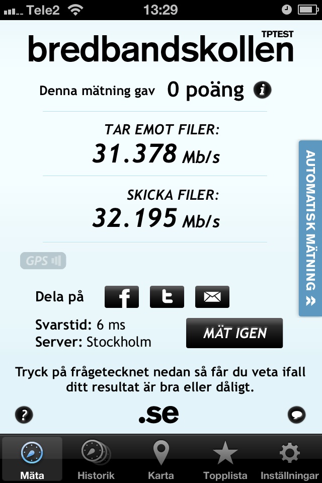

    What's your wifi speed on the ipad2 vs the iPhone?
    I get 30Mbits up and down as max thus far when benchmarking on the 4S, i think that is by far enough.. Too bad i don't have an ipad2 to do a comparison with.. And i hope you got something faster than 30Mbit seeing that you claim that it's faster in the ipad2, not that you'd need faster than that on a phone.
    But i do understand why one is curious on which is faster and by how much etc.
    Screen below from said benchmark, sorry it's in Swedish, but i think you see the important bit, the numbers :) The first is receiving files while the other is sending files via WIFI. Accesstime 6ms... pretty fast if you ask me!

    Dunno who you are talking to, but I didn't claim iPad 2 had faster WiFi, only that it had 5GHz.
    It's 5GHz transceiver and antenna system is only a 1x1, single spacial stream. That means it is max theoretical bandwidth of 72mbps. After protocol and encryption overhead, max realistic should be around 32mbps. I've personally seen 29.60 Mbps over 5GHz WiFi to speedtest.net on my iPad 2 (not an ideal test, but I don't care to invest time either).
    The 2.4GHz N should be the exact same speed, 72 Mbps single spacial stream.
    It's merely a matter of compatibility if you don't have a simultaneous dual-band router, or if you have a lot of congestion on the 2.4 GHz band. Like if you live in a dense apartment or condo complex, rather than owning a home with neighbor separation.

    No, not you, the OP of course :)
    But your explanation seems to be spot on for the 4S as well as i'm reaching 32Mbit.. Though i've seen screens of one user who hit up to 36Mbit down, though that's not a big difference.
