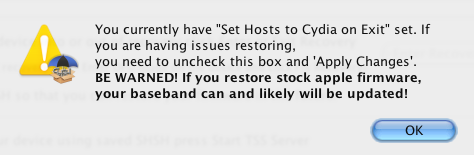

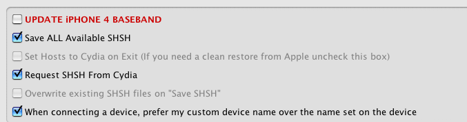

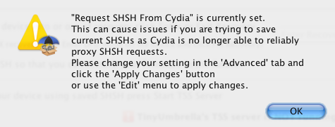

    Besides, when starting TinyUmbrella, I get weird warning messages:

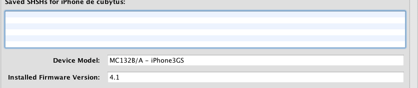

    Which is not true:
    So how do I upgrade it to 6.1.2, then?

    That's not how it works any more.
    You need to create a custom 6.1.2 ipsw if you have blobs for 6.1.2 for that device you need to stitch those to the custom firmware.
    But before you go any further find out if the 6.1.2 blobs you have are full or partial. Use ifaith.
