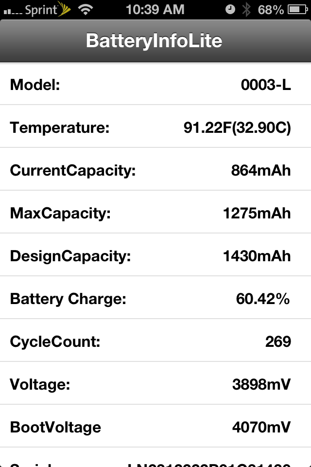

  10. dbrewer80221 macrumors regular
    Joined:
    Jun 16, 2009
    #10
    If you jailbreak your phone, there's an app called BatteryInfoLite. This app will show you the original design capacity of your battery, and the current max capacity of your battery. Using this, you can find out what percentage of the original battery life your phone still holds.
    In the attachment, you can see that the original capacity on my 4S battery is 1430mAh. The current maximum capacity is 1275mAh. This means my battery can currently hold 89.16% of its original charge.
    You can also see how many charge cycles your battery has been through. Seeing as how Apple states the iPhone batteries are designed to hold 80% of their charge after 500 charge cycles, I'd say I'm right on target at 269 charge cycles.
    I'm surprised at how quickly I went through 269 charge cycles though. This was a replacement 4S I got in September 2012.
