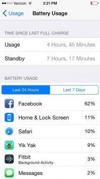

    So I have an iPhone 5 that I've had since January 2013. The battery is still the original, but I've rarely had problems with battery life. I charge it overnight and it goes all day until I go to bed usually.
    All of a sudden it's not even getting to the end of a typical work day. I'm a student so my schedule isn't 9-5, but it shouldn't be at 20% at 2:00 when I unplugged it at 10:00. The only things that have changed recently are the 8.4.1 update a few weeks ago now and some app updates. Facebook has always been a battery suck, but I don't leave it running in the background. In fact, I close apps when I'm not using them (namely to save on data), no background app refresh, and location is pretty much only set for certain apps when I'm using them.
    What is causing this sudden drop in battery life?! Could it really be just the fact that my phone is 2 1/2 years old and has gotten a lot of use? I don't think it qualifies for the battery recall, and in outside that window anyway, I think.

    #8
    The weird part is that the times listed don't even make sense. Seven hours of standby? It wasn't even unplugged for that long! I had it unplugged for about 4 hours (probably the length of the usage time), and it dropped to 20% in that time. Maybe it's time to wipe it and reinstall. Normally I'd wait for iOS 9, but this is ridiculous.

  21. airb330 macrumors member
    Joined:
    Jun 5, 2012
    #22
    The battery life doesn't look that bad if it is mostly screen on usage. If you have had your screen on for most of the 4+ hours, then that's why the battery is low. If most of that usage is screen off usage, then something is definitely up with Facebook. If you haven't, then I'd try deleting facebook and reinstalling. I wish apple would show screen-on time.
    Verizon, in my area, doesn't have the densest network and was always hanging onto weak 1X and LTE signals which never helped my battery. LTE signals with high "noise" (aka RSRQ) would absolutely destroy my battery as well as cause very slow speeds. Perhaps the network changed somehow and if you are getting terrible RSRQ (no good way to measure this on an iPhone unfortunately), that could absolutely be the cause.

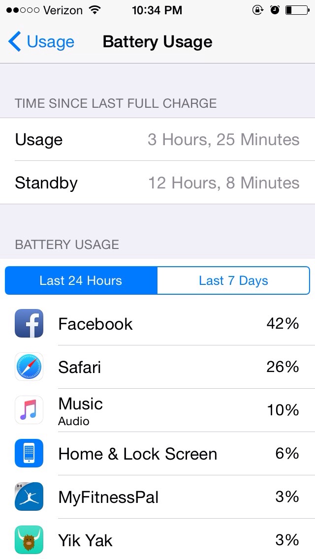

  23. Ultra AleM macrumors 6502a
    Ultra AleM
    Joined:
    Jun 22, 2012
    Location:
    Italy
    #24
    The screenshot you posted is not bad. It's a good result for an iPhone 5. Anyways, check your battery left capacity with Coconut Battery on your Mac and let us know.
  24. KUguardgrl13 thread starter macrumors 68020
    KUguardgrl13
    Joined:
    May 16, 2013
    Location:
    Kansas, USA
    #25
    This is from about a month ago.
