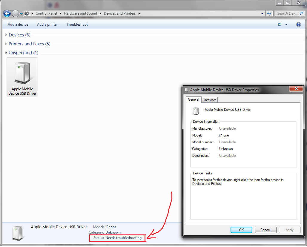

This is my personal machine and I have connected my iPhone 5 to the computer and followed your instructions and this is what I get.
Uninstall the driver, then unplug the phone and then plug it back in to reinstall the driver and see if that corrects your problem.

This problem is now resolved! I have contacted Applecare and they helped me to resolve this problem. I had to disable forced driver signing enforcement when I restarted my computer :apple:.
