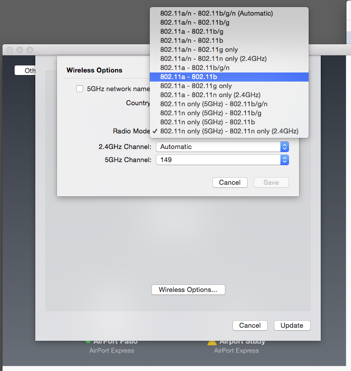

Menel
Suspended
Aug 4, 2011
6,351
1,356
So this means I have to update all my iPhones and iPad to get it to work
Yes, automatic/compatibility mode makes the router operate at the least common denominator.
The phone always shows b/g/n connection and my iPad and macbook are showing as a/n.. is this normal?
do you know if its possible to set just the iPhone to ac and have all other connections on n?
I have the older Airport Extreme, but this is why I set mine to strict only N mode (see the checkmark in attachment), so that any G devices, visitors or whatever don't pull it down. Yes I have a crappy G device pioneer airplay radio, that I run a separate Linksys for.
You could also set a different name for the 5GHz network. Not give that new name to any device other than your iPhone 6. Leave all other devices on the 2.4ghz, and your lone AC compatible iPhone 6 to use the 5ghz band and AC.
