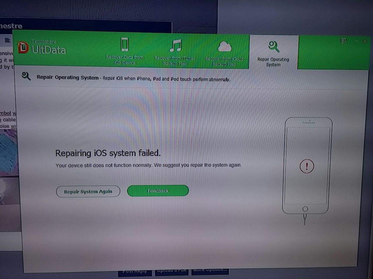

I also noticed that the apple symbol with the loading bar does not appear, nor does that itunes symbol with the design of a usb cable,he screen only goes black during the restoration process, then it makes the connection noise with the pc and the error
erro in itunes last version

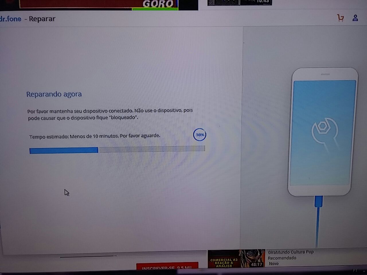

dr fone see iphone

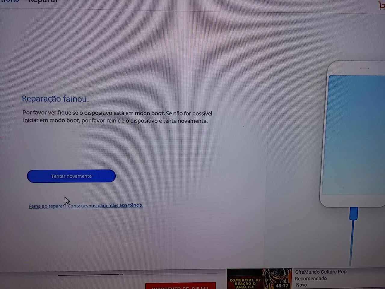

in 51% process stop and erro .
dr fone erro say : repair fail , button blue say try again.
not working in this soft
