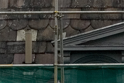

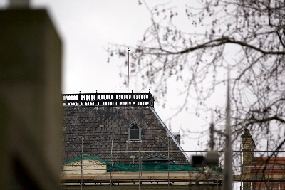

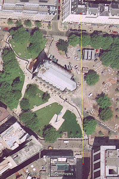

    You should be fine with a 200mm lens. I shot this rather unexciting image (was trying out a 300mm lens - on my 5D)....
    [​IMG]
    Close up of Flue (image sharpened)
    [​IMG]
    [​IMG]
    Distance according to google earth is 165 Metres.
