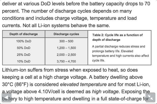

    Letting the battery completely die will kill a lithium ion battery. But when the phone says 0% there is plenty of power left in the battery. Some people will notice if you leave a device on a shelf for a LONG time then goto charge it the battery only last minutes, this is because the battery actually got to or near 0 volts.
    For battery longevity charge it above 50%.
    Check out this chart.
    [​IMG]
    As you can see charging at 50% is better for the longevity of the battery then at 0%.
    Using a charger with lower amps will keep it cooler and aid in battery health too but it will charge slower.
    Letting it die will help the % indicator be more accurate as the battery health changes overtime.
    Leaving it plugged isn't good for it either. Devices I keep plugged in all the time batteries don't last very long. Like standalone GPS devices, if I were to unplug my Garmin the battery will last about 30 minutes. Check out this link.
    http://batteryuniversity.com/learn/article/how_to_prolong_lithium_based_batteries
