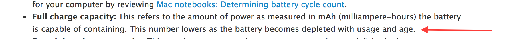

Using that link, it also says "Age" has some effect on battery life as well, not just cycles.
