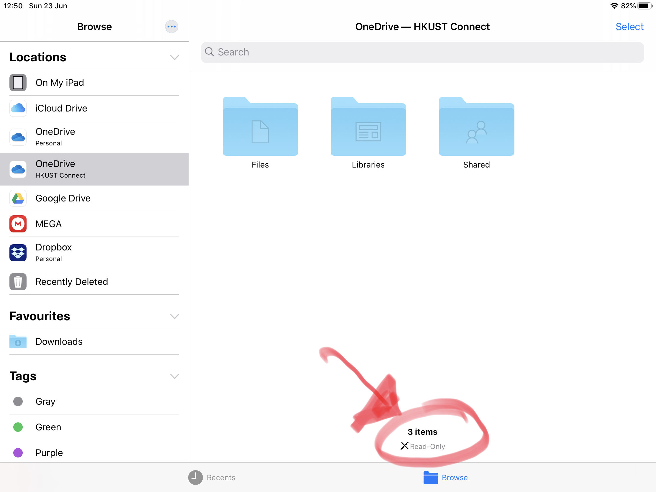

OneDrive from the files app and from 3rd party apps (I mean, every app except OneDrive itself) appears as read-only. Do you also have this issue?
What do you mean by "appears as read-only"? How are you identifying whether a target is read only?

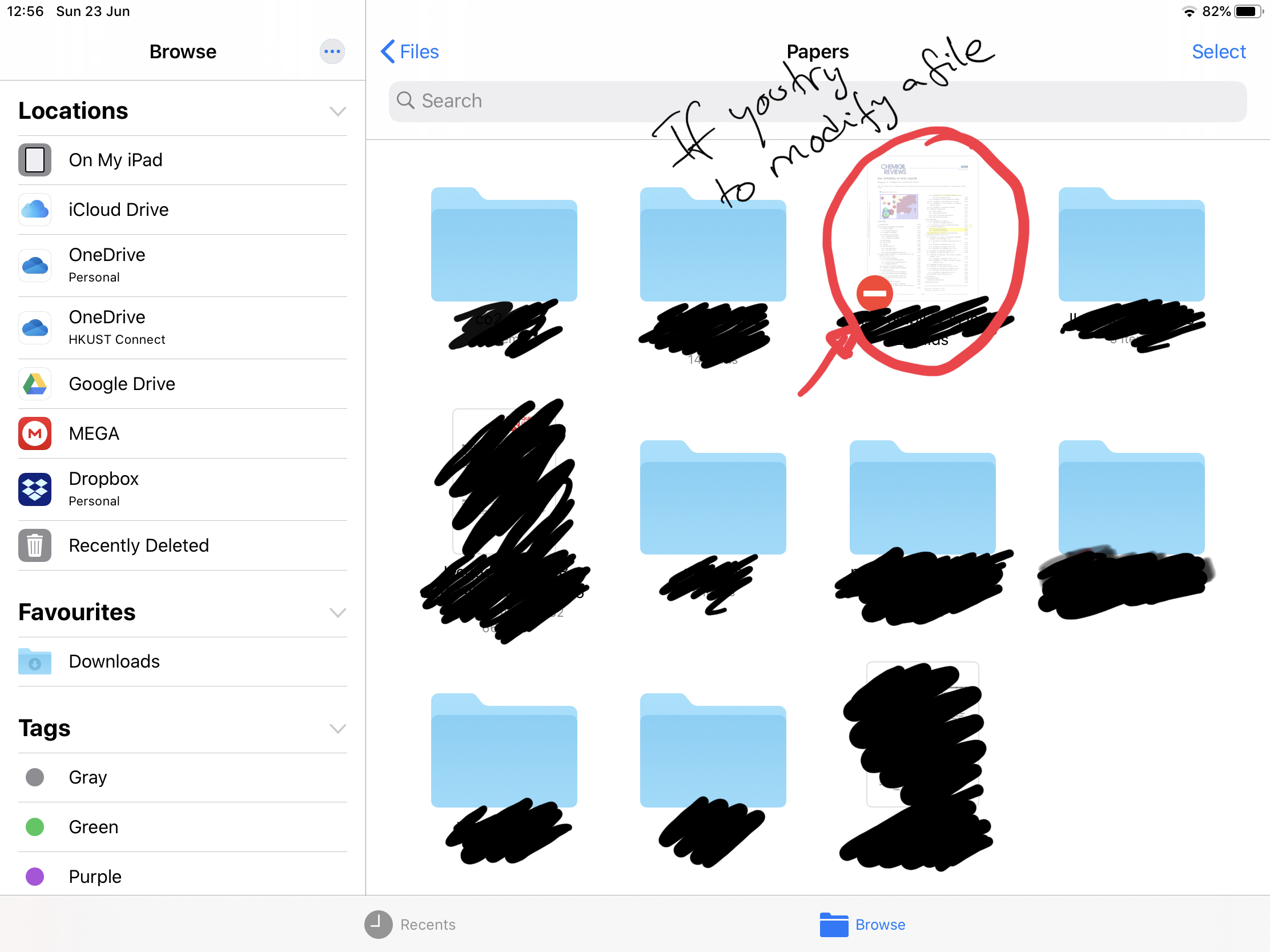

This, and this is what happens trying to modify a file
That's a bit clearer. I've definitely never seen that "Read-only" thing. Not on One-Drive (either my corporate account or my personal account). Can you describe the process you go through to get here? For instance what app you may be using to modify/save a file?

I’m testing so far PDF viewer and just the apple app (opening just the file through the files app). iCloud is the only one that successfully uploads and updates the changes between both apps with no issues. In dropbox, google drive and OneNote, the changes are not actually being saved in the pdf file, even if only OneDrive shows the “read-only” in the root of the filesystem (so maybe the read-only just means you can’t add new folders in the root). Mega is not even loading the files.

Ok, i’ll Tell you the simplest case scenario, how it works in my iPhone X with the latest stable iOS 12 version, and how it works in my iPad 10.5 pro with the latest ios13 (IpadOS) beta 2 version:
- I open a pdf file in the files app in my iPhone X from OneDrive.
- I modify the file by using the mark up tool from the default app that apple files app uses to open the pdf
- i just press back and in the iPhone, the changes are automatically saved and uploaded to the cloud (in any cloud), but my iPad does not save the changes (except for iCloud).
The same happens if trying to modify the pdf with pdf viewer for example, the changes in the pdf are not saved back to the cloud, and from the iPhone there’s no issue.
However, i found that i can create new files (new pdf file from pdf viewer for example) and the new file shows up, but again you can’t modify it.
So the issue seems to be synchronising changes made to already existing files in other cloud other than iCloud in the beta. Right?

Thank you so much for clarifying this. I've spent some time and been able to reproduce at least part of the issue, but only for OneDrive. On My iPad, iCloud Drive and WD MyCloud providers all this worked fine. I was able to save a PDF, go to Files and use Markup and it was reflected on all my devices. For OneDrive I saw that weird red dash icon for a few seconds then my markup changes were not saved. I'll write up a report for this now.
I still haven't been able to see/reproduce the "read-only" thing you see.

The read-only message is just showing in the root of OneDrive and OneDrive for business, inside the directories it’s not showing anymore. But even in the root, in iOS 12 (iPhone) is not showing the message...
