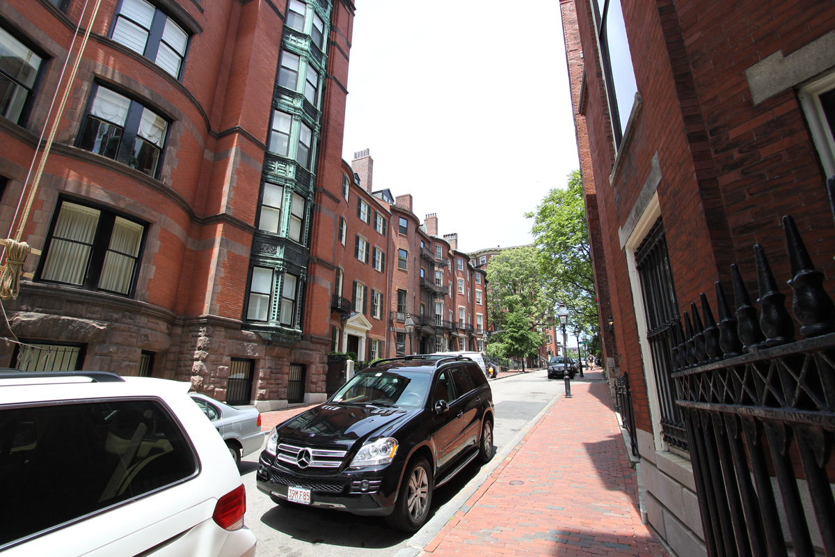

    First some background. I recently got my first dSLR (Canon T1i) and after using it for a little over a month I decided that I need a wide-angle lens to compliment the kit lens (18-55) and the Canon 55-250 I bought for it (I also bought the Canon 50 f/1.8). So on Monday night (after one too many glasses of wine) I went ahead and bought the Canon 10-22 f/3.5-4.5 USM ($699 from Adorama).
    I got the lens on Wednesday (shipped to my office, since I didn't want my wife to know I bought another lens, costing almost as much as the camera!), and took it out on the town (Boston) at lunchtime, seeing it was a beautiful, sunny day. I took about a hundred shots in a span of an hour, and while there are quite a few that I am very pleased with, many leave a lot to be desired.
    As I said, it was sunny day, with plenty of blue in the sky, as evidenced by the first shot attached at the bottom (statue of George Washington). This (and a few other shots) notwithstanding, a lot of the other shots came out like the other three you see here, with the sky looking almost white, as though the picture was overexposed, which it clearly is not, judging by other elements (buildings, cars, people) in the photo.
    At this point I'm leaning toward returning the lens (a hassle and an expense, more so since I'll have to insure the shipment back to Adorama), because even though I've taken some amazing shots that I would not be able to take with any other lens (e.g, a picture of my wife's 6' circular flower bed while standing right beside it, which looks as though it was taken from 15 feet up!), the inconsistent color/exposure is a deal breaker for me.
    Now it's possible that I could improve this by using a polarizing filter, but I seriously doubt it. All the attached shots were taken in P mode with auto ISO, auto f, auto speed, the only adjustment to full auto being a little bit of in-camera sharpening. I feel the lens is not worth $699 for the few keepers that I could not otherwise get with my other lenses, of which I like the 50-250 mm the best (very sharp, consistent IQ)
    I'm trying to decide between these three courses of action:
    1. Keep it and see what happens after I put the polarizer on the lens.
    2. Return it and live with the lenses I have, until I gain more experience with the camera.
    3. Return it and buy something not as wide as the 10-22, but more versatile and sharper than the kit lens (which I like the least of the 3 lenses I have)?
    I would appreciate any advice, especially from those who own or have used the 10-22.

    Three of the shots are over-exposed, 12 noon is really about the worst time to shoot landscapes/cityscapes as the light is so harsh. Overexposure is not the lens' fault though, it's the camera settings.

    I'm not an expert but from what I see there, I would say it has nothing to do with the lens.
    What mode are you shooting in, P, Av, Tv, M, what is your metering set to, whay ISO?
    Looking at picture #2 with the black Mercedes SUV, the right hand side of the pix has a lot of shadows & the exposure seems to be set for that dark area, which would blow out your highlights. The other 3 seem the same to me, the exposure is set to keep the shadows open & properly exposed, which in turn over exposes your highlights.
    I'd say keep it, I have one myself & it's a great lens.

    If you look at your second, but especially third and fourth images they all have something black or shadow in the centre of the frame, were you using spot/centre weighted metering? If so the camera is trying to compensate against these very dark areas trying to brighten them up, and effecting the whole scene. Might wanna try some mild HDR for those tricky exposure situations to capture all that dynamic range.

    Looking at the photos, and I make no claims to being a pro, but there is nothing exceptionally wrong with them, #1 looks fine, #2 is what I would expect from the lens in that scenario. I used a 10-22 on a 30D for a lot of pics around Sydney and had few issues.
    There doesn't seem to be anything wrong with the lens at first look, but keeping in mind how wide the lens is you either need to frame the shot well or maybe do some trimming afterwards as at the edges it can stretch objects. To quote my friend who owned the gear I borrowed.. he took some pics at a wedding and "didn't remember those people being so wide" :)

    I'll agree with everyone here. The lens isn't the problem; it looks like it's a pretty good copy (sharp in the corners, low chromatic aberration). The problem is that you're trying to take pretty high dynamic range photos, and the camera appears to be using center-weighted metering so you're metering for the buildings and blowing out the sky. If you would dial the EC down a stop you'd probably be OK with a little PP in Aperture or Lightroom (increased exposure with highlight recovery)

    overexposure and a blown-out sky is the camera's fault, not the lens. i suggest you read up on exposure, metering, and metering types (evaluative, center-weighted average, partial, and spot). here's something to get you started: Understanding your camera's built-in metering system.
    also, there's also something called the sunny-16 rule: outside, in broad daylight, the "correct" exposure is about f/16 at 1/ISO seconds, e.g. if your camera is at ISO 100, you should be at f/16 and 1/100, or f/22 and 1/50, f/5.6 and 1/800, etc. this way you can introduce yourself to "M" mode, or to double-check that your camera's metering is reasonably close (if you're using P, Av, or Tv).
    mid-day is a problem for all cameras though, since there's simply too much dynamic range for any film or sensor to record. you can either keep the sky and lose the shadows, or keep the shadows and lose the sky. a polarizer or neutral density filter will not help - they will only reduce the exposure.

    This is a problem with dynamic range. It has nothing to do with your lens, and nothing to do with your camera being defective. Camera sensors simply do not have as great an ability to "see" really dark shadows and really bright skies at the same time......certainly not as good as the human eye. That's where decent metering skills, and some photo editing come into play.
    Get a grad (gradient) filter so that you can get a dark sky and still expose the lower half of the photo with no problems. That, or learn to use your camera and meter. I would have gone for a bit less exposure so that the sky could still be saved, and then raise the exposure in the shadow region (just move one slider in Aperture or Lightroom). If you photograph it so that the buildings aren't completely dark, the buildings will still look good after editing.

    Like I said before, I doubt it's the lens. The problems you're having will happen in any situation where there's extreme light (sky) and dark (shadow). You either expose the photo so that the streets look good, or you expose for the sky so that the sky looks good. The other solution is a gradient filter, which will make the top half (or top portion) of the photo darker than the bottom. That way, you can expose so that the buildings look good, while the sky will also look good because you're not getting too much light exposure from the sky.
    So get another lens, or get a refund. It won't help whatsoever. You'd have the same problem with any lens under the same conditions, but since you say that getting good photos requires too many manual adjustments of the lens (??????), perhaps you could learn a few things about photography before you go on your trip. That, or buy a film camera. Or just go without a camera.

    As others have pointed out, there's a 'learning curve' with any new piece of kit. Picking exposure values that render land and sky 'correctly' is a problem that's been confronting photographers for, oh, at least 150 years. :)
    Your results look consistent with what happens when you let a camera make up its own mind. Don't blame the equipment till you've given it a thorough workout. Have patience and learn about the potential of your new lens: what it does well... and less well. Every lens has a slightly different 'personality'...
    There are many 'workarounds' to get foreground and sky correctly exposed. All require a bit of effort (ie not leaving it to the camera... with a 'programme' setting), with a grey grad filter being one of the simplest & cheapest.
