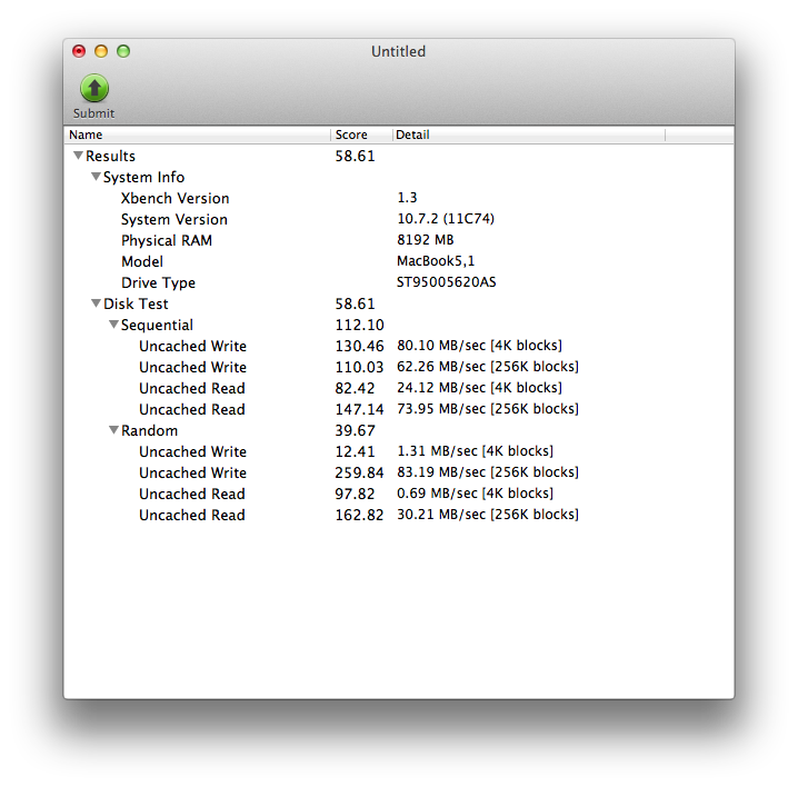

    I have a Momentus XT 500 GB that I purchased from Amazon in August 2011 for use with my "Late 2008" MacBook (MacBook5,1). The XT came with SD26 preinstalled. I installed SD28 when it came out (about a month of having the drive), as some users were reporting increased performance. Didn't really notice a difference.
    It seemed to be working fine (snappier than the stock MacBook HD for sure) until about a week ago, when I began to notice a BIG decrease in system performance. Ran a SMART status and everything is fine. Did an Xbench test and my sequential write score was 86.66 (so-so for this model HD compared to other people's scores on the forum), and 22.26 for the random score. Those are a tad better than the average HDD, but not nearly as fast as it was. More importantly, the system feels MUCH lagger. I used to click an icon on the dock and it would *maybe* bounce for a second, but would open so fast I couldn't really count a second. Now it takes about 3 seconds. Also, I'm getting beach balls all the time, and in general it just takes longer to open files (especially large ones).
    To rule out a possible OS problem, I've wiped the HD clean and re-installed both Snow Leopard and Lion (Lion being a bit better but still not as good as it was when I first got the HD). I am positive it is NOT due to the OS, and even if it is, I want to be sure my HD isn't defective.

    Here is one a few minutes later, after a backup was completed. How are these numbers? I swear that it feels much slower than what the Xbench makes me think it is. 4-6 seconds to start iTunes or iPhoto, and longer to open a PPT with Keynote (which, IMO, is ALWAYS super slow). What do you guys think? Maybe I just wish my setup was faster....
    Boot times are about 40 seconds or so.
    I think SSD would get me in the low teens for boot times, but people are getting that with the XT (and i'm obviously not). So maybe my hardware is just not up with the i5's and i7's? Why is my performance less than other's XT performance??
