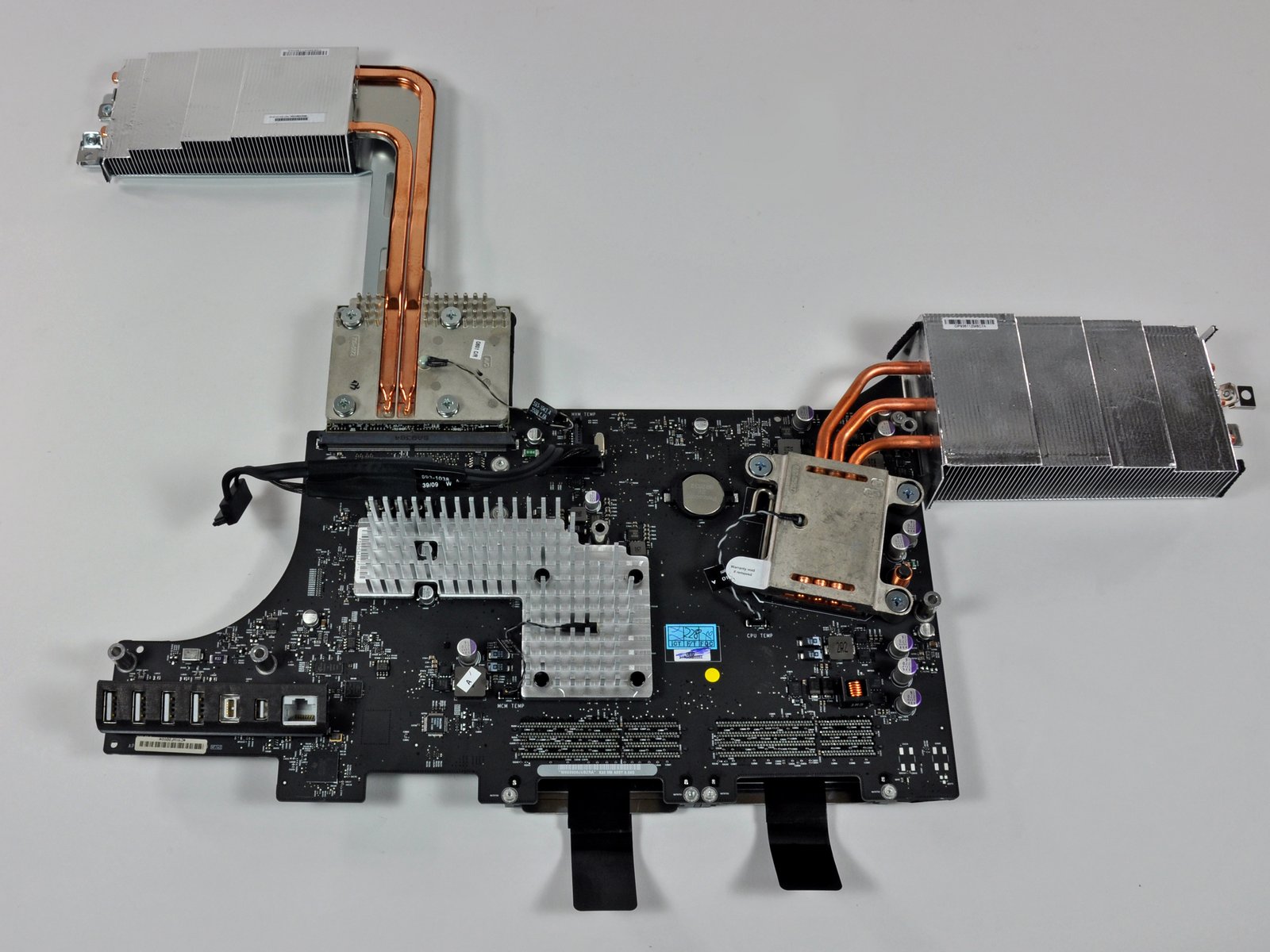

As the question in the title, I've done some research and this is what I have found. My intent is to install this video card into the iMac late 2009 with hd4670.
First seems that Imac 27 uses a MXM-B connector and 21.5 uses MXM-A Connector FONT.
Infact my HD 6670M 512MB has MXM-A Connector, and have 70mm lenght and 82mm width!
From WIKIPEDIA says that MXM-B IS RETRO-COMPATIBLE WITH MXM-A (not viceversa but is not my case).
So if my suppositionsare correct; can I install the 6670M in iMac 27 late 2009? There is any software incompatibility?? Thanks in advance!
Sorry for english again! P.S. My question is about only to install this video card on this Imac, don't reply with other video card suggestion! THANKS :)
P.S. From Ifixit there's an image of the motherboard of iMac 2009; and it is very similar to the imac 21,5 motherboard with ati 6670M
