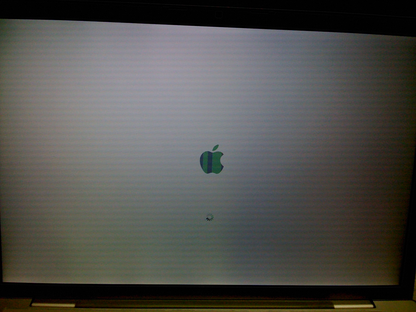

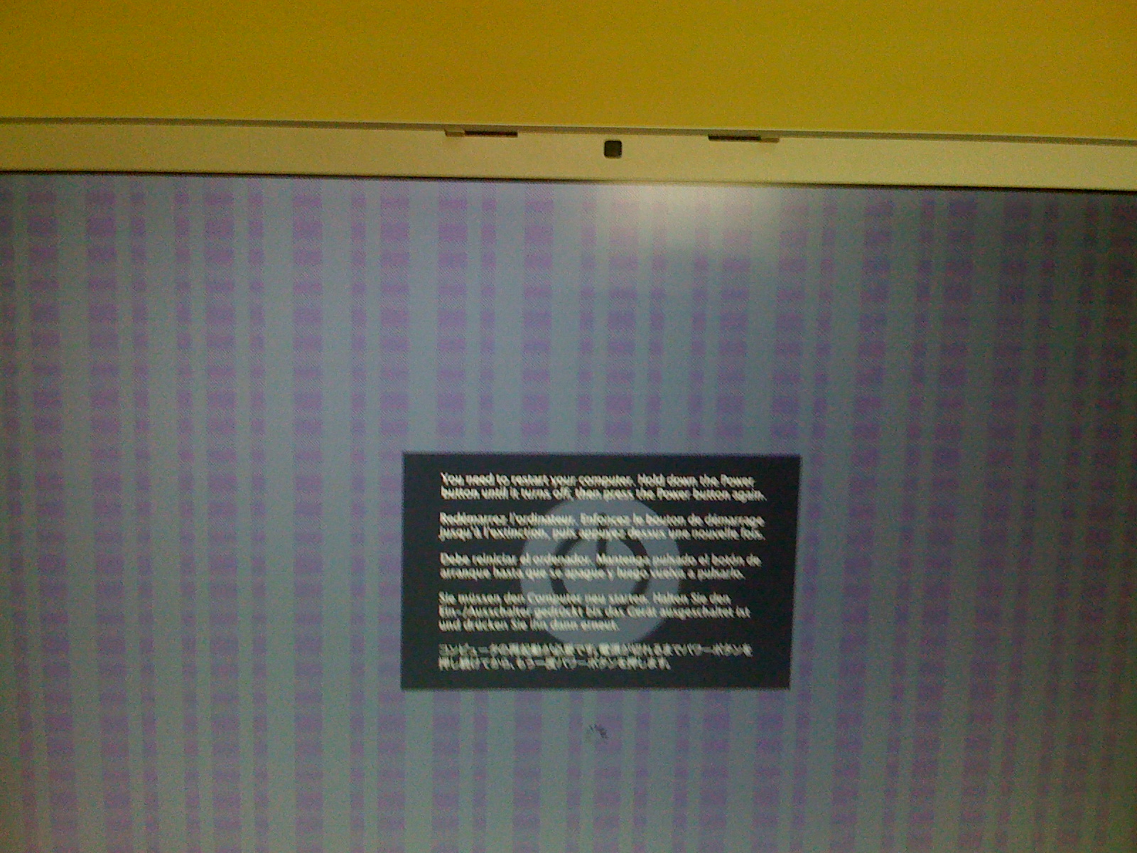

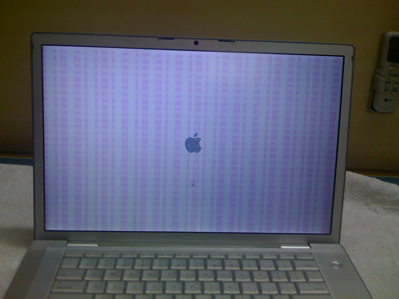

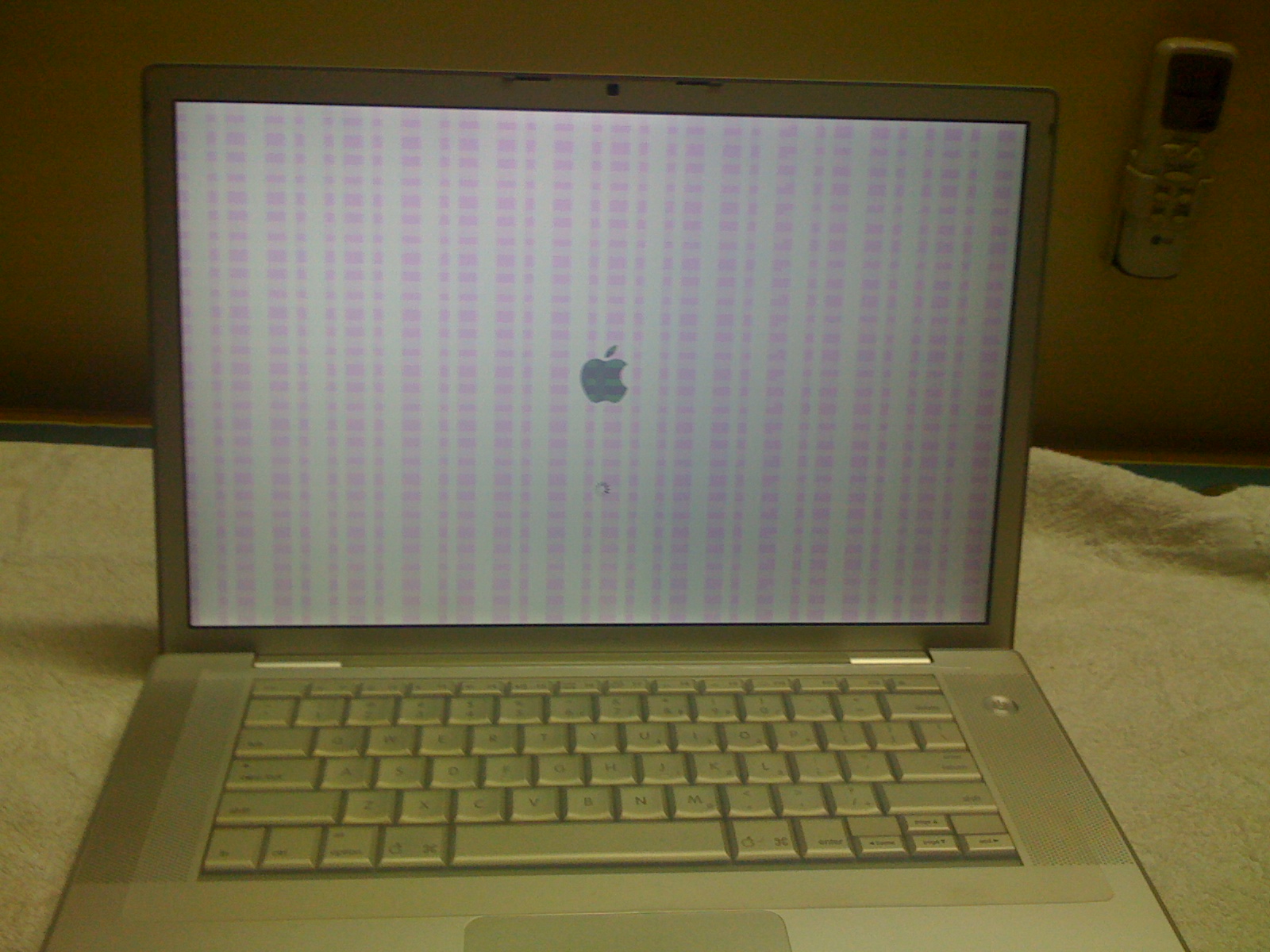

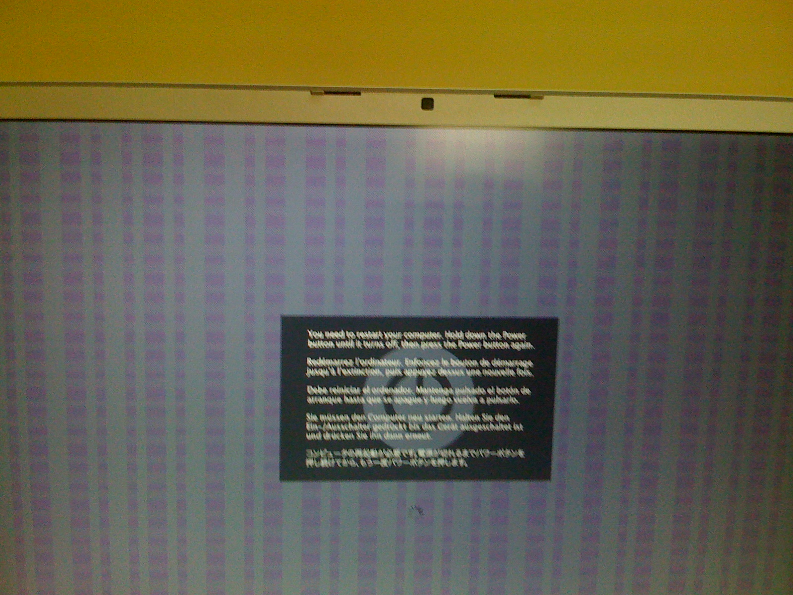

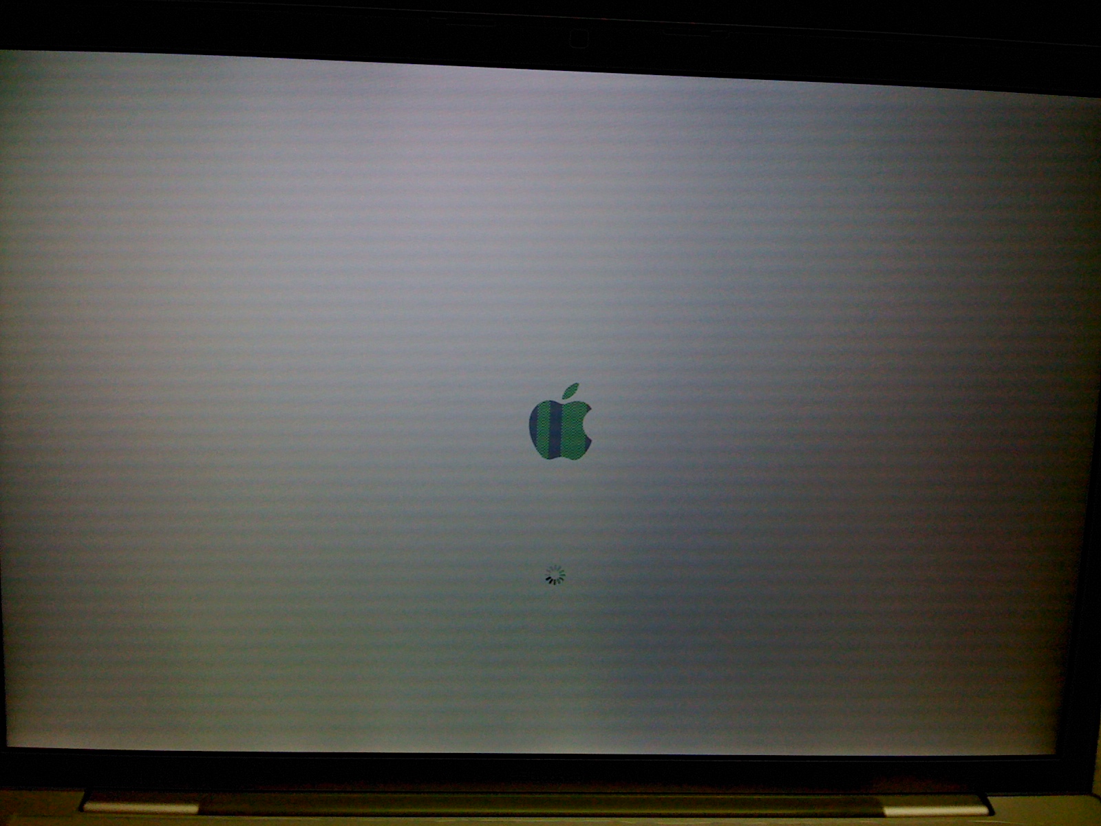

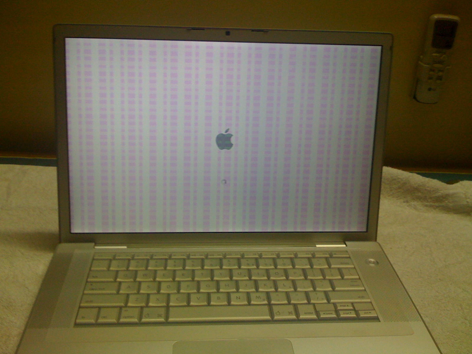

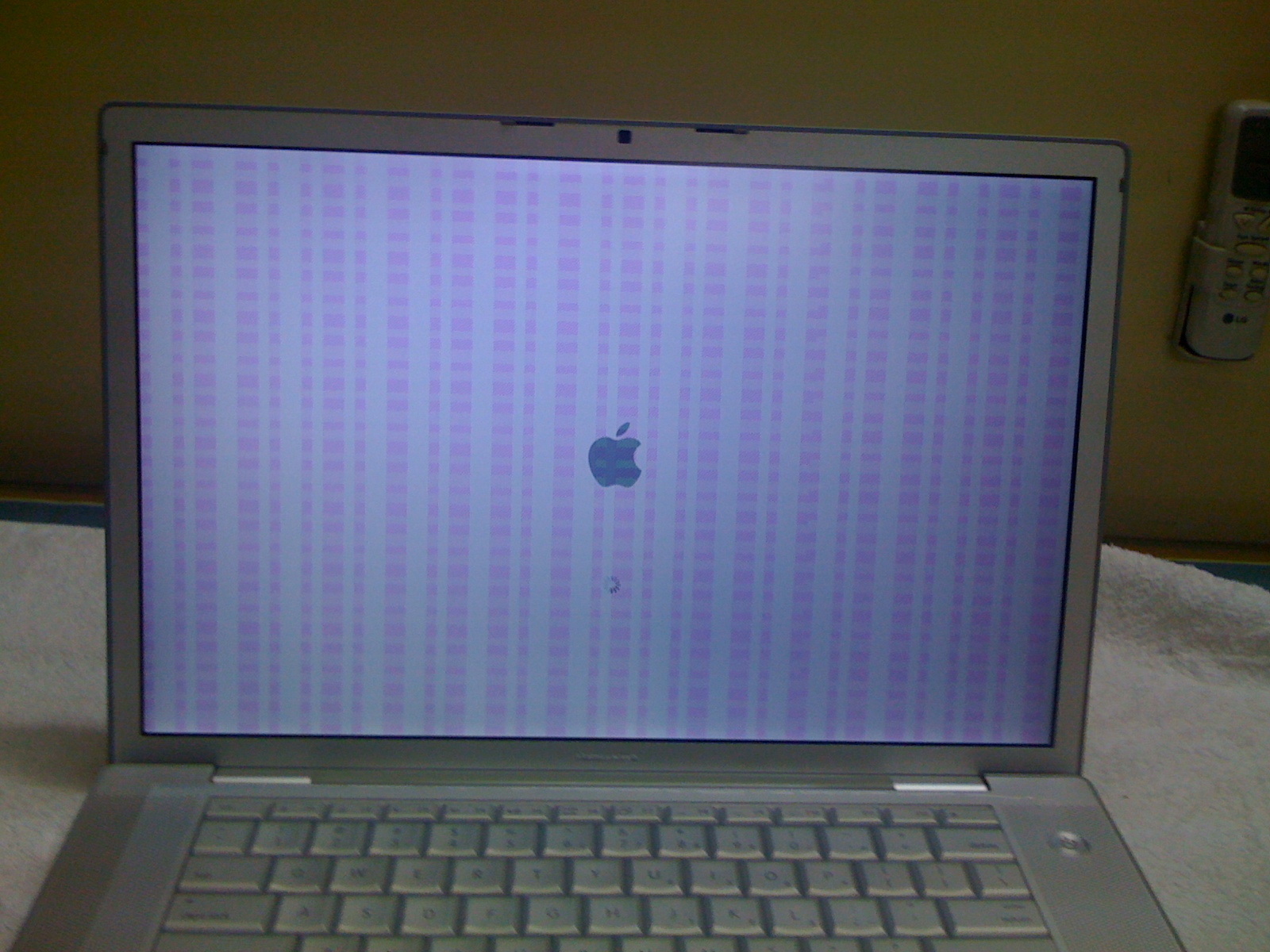

Hey guys....was chatting on skype when all of a sudden my MBP decided to go all artistic on me by painting the screen with colored stripes. I restarted my system only to be greeted with the colored stripes again..it eventually came back to normal on the 2nd restart...
Is this the sign??? the sign of the 8600's impending doom...
P.S : the photo quality is not that great....it was taken from my iphone 3g

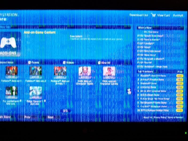

I was going to suggest it might just be a loss cable, but since it "fixed" itself after a while, its most likely the graphics card. I'd get it to a Apple Store ASAP. Here's hoping the problem doesn't repeat itself till then.
PS Its rather funny that you have this issue because I had the same problem with a used PS3. Happened when the system got hot (which many ps3 owners know is soon after its turned on). Looks almost exactly the same too.

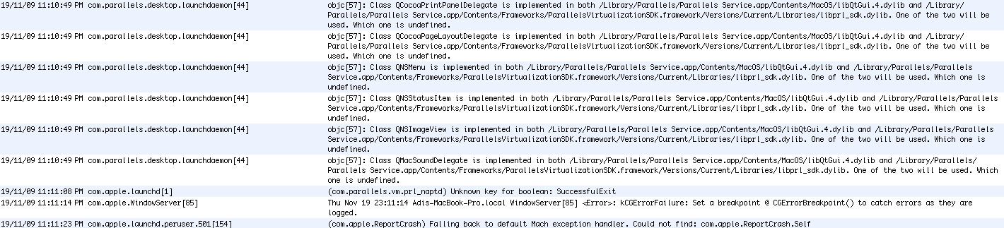

hmmm...yeah...i will take it to an Apple store today....I am now also thinking that this could be because of the 10.6.2...since it never happened before....
If it is of use to anyone...here is the stacktrace :
lol. MBP went artistic on you.
Yeah, it might be the great 8600 issue. If it is a loose cable, it would cause the kernel panic on your computer.
Report back to us. I'm curious to! Good luck.

when you say loose cable...u mean the power cable right?

I think this is a pretty strong indication that it is a problem with the graphics chip itself, not just a loose cable.

damn...my MBP is really artistic..after innumerable panics yesterday..i get something different this time.....Thank you Apple....
I was working on a project which I have to deliver this weekend...and bam....freeze...and panic...
all of a sudden..this apple has started to smell rotten to me...
apparently...there are many others who are facing the issue....googling on NVResman WindowServer and 10.6.2 gave me quite a few hits...
I m in India..so Apple does not even fart in this direction...they don't care about us here...so I am pretty worried abt taking this to an 'Apple' retailer...their ******** might drive me to suicide...:rolleyes:

parallels 5
wel...i hope its not too early but me thinks that parallels 5 is the cause...
I was trying out the demo since the last two days....(the panics started to happen soon after)...I noticed these error messages in the log....
So I proceeded to completely uninstall PD 5 and viola...no panics since then....
great!!!
Right now..i am scanning my mac for all third party apps and updating them to SL versions....else they all go to trash...
macjunk(ie)
macrumors 6502a
Aug 12, 2009
910
504
well....apologies for all the parallels fans out there..as it turned out..minutes after i posted abt PD5....a kernel panic...:eek:
so..i am now back to good ol' Leopard..here's hoping that the problem is solved....(cause I really can't afford a 1000USD bill right now...)

and there...I had my first kernel panic on Leopard...windowserver ad crashed......the thing is...the panic is a bit more graceful on Leopard..at least..i dont get the striped screen...
i will just wait till the card fails completely...until there is no display and then i will take it to the apple store...
macjunk(ie)
macrumors 6502a
Aug 12, 2009
910
504
so..it turns out that it is indeed the GPU problem..its been almost a week now...I am yet to get the laptop back from the service center....:mad:
