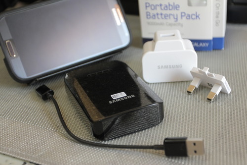

    is there a portable battery large enough to power the 11.6" MBA for an hour or two?
    I just realized that the batteries in my iPad and MBA are both a little over 5000mAh.
    I have a 9000mAh Samsung portable USB battery that can power the iPad.... just wondering if there's a way I can use it to power the MBA?
    This is the battery that I have...
    http://www.amazon.com/Samsung-Unive...artphones/dp/B009SK5B3O/ref=cm_cmu_pg__header

    but how do I connect my Macbook Air to the battery's USB port?
  4. Mrbobb macrumors 601
    Joined:
    Aug 27, 2012
    #4
    There are enough capacity (apparently) but the voltage is wrong.
    USB puts out 5 volts, I believe the Air needs like 9 volts or more.
    I am pretty sure there are external battery pack for the Air, is just money Jack!

    You need an airline MagSafe adapter then you can buy a usb>airline adapter adapter if you get me lol.

    The air will not charge from a USB port - the device you have is for phones and tablets that charge from a USB port. the laptops need more power and a magsafe connector. The USB ports on the laptops are output only.
