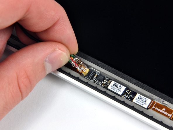

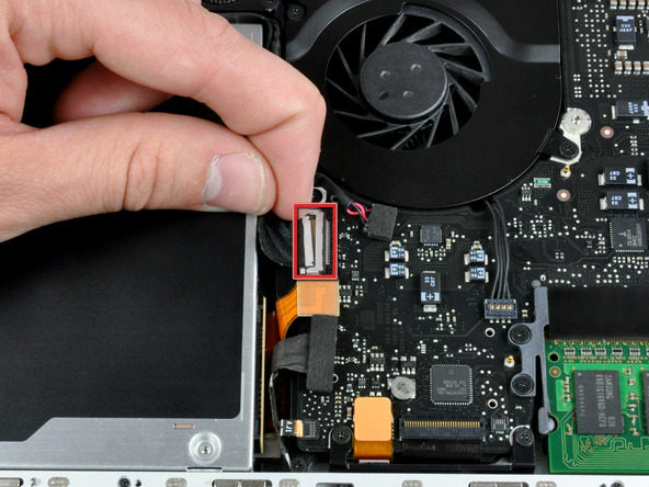

    If that doesn't work, it is possible, though not super likely, that the cable may have come loose over the years. The easy side is the connection to the logic board:
    [​IMG]
    The other end though, much more difficult to get to and it involves heat guns, adhesive, and suction cups :eek:
    [​IMG]
    It can be replaced using this guide on iFixit. But it may be trivial to do so unless you really need it. Otherwise, a simple USB webcam would suffice for much less. Like $20 and you're good :D
