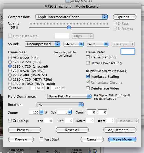

I have the HD1000 and had the same problem. Like you I shoot all my video in 720p (60fps), the only way I could get great results was to convert the HD1000 files to .mov using a program called MPEG StreamClip. Once loaded select Export to Quicktime and see the attached for the rest of the settings.
I can now import and edit with FCE with no problems.
Hope that helps

I was just looking at your settings - it looks like the mov file will be interlaced. Is this correct? You shoot in Progressive 60 fps right?
And can FCE export 720p at 60 FPS?
Also, do you know if FCE can handle 1920*1200? I have seem some reports of it being limited to 1440*1200 (which I think is the anamorphic resolution).

Hi, you've got me on the interlaced bit, I didn't even notice that setting. However under Frame Size I did try 720p and it started to drop frames and judder.
So far I've only tried to export at 30fps at 720 which does work fine, not tried 60.
So far i've only managed to get 720 in FCE, any higher can cause frame dropping or even the annoying green screen, I think Apple needs to get the xxxx in gear and get this sorted out so we can start using higher resolutions .
Best to give it a go and play around with the settings.
